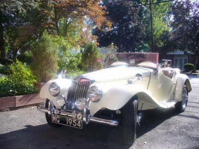

Pulled the gearbox and all looked in perfect shape. Moving forward, removed the clutch plate assembly and found one of the springs holding one of three release levers inside the clutch plate assembly had shifted position and had stopped the lever from functioning. Used a screwdriver to move the spring back, reinstalled the clutch plate assembly, slid the gear box back into place, dropped the MG off the jack stands, turned on the key, pulled the starter, engine roared into action and the old timer slipped flawlessly into first gear.
Thanks for your help and support.

Excellent news That is a Beautiful Car drive it with pride and a BIG smile
