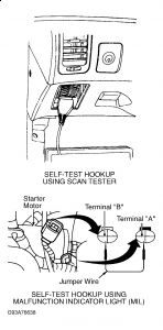

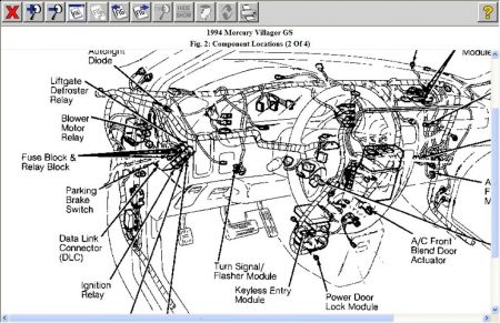

Where in the world did they hide the diagnostic test plug for my vehicle? Looked under dash didn't see it on either side, also looked under hood and didn't find it.
Mar 23, 2009 at 4:14 PM
  • CAR REPAIR CONTRIBUTOR
  • 75,992 POSTS
See below-Data Link Connector
https://images.2carpros.com/forum/automotive_pictures/12900_dlc_3.jpg

Hello .. thanks for the donation .. much appreciated Hope this helps .. if you need any more assistance let me know !! Trouble codes are retrieved from EEC system through Data Link Connector (DLC), located behind left side of instrument panel below fuse/relay panel. See Fig. 2 . Follow scan tester manufacturer's instructions to retrieve codes
https://images.2carpros.com/forum/automotive_pictures/266999_2_16.jpg
