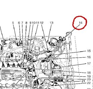

The codes that was giving to was a bad cam sensor or crank sensor and a random miss fire. Could you please tell me where these sensors are. Also they recommended a tune up what type plugs do you recommend resistor or platinum.

Autolite plug # is xp5144 .054 gap.
The sensor is on the back of the head, #7 on the diagram

My Pleasure, The Camshaft position sensor gives the computer information of the cylinder' position so the computer can give output signals for the correct ignition firing.

How do I change the cam sensor if I take it out do I have to line anything up. Or can I just take out the one bolt that holds it in and put the new one in.
