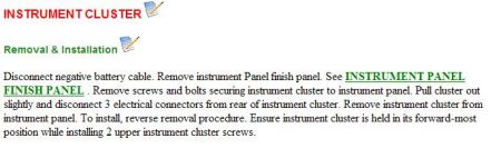

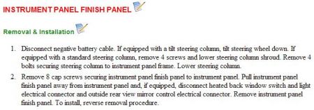

i need to replace the light bulb in the dash.
how do I remove the dash board?
Wednesday, October 28th, 2009 AT 3:44 PM
BLUELIGHTNIN6
MECHANIC
16,542 POSTS
I'm assuming you mean a light bulb behind the gauges? .. If so, steps are below..
