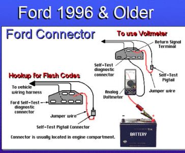

i need to know how to set the timing on my 1995 mercury tracer it has the 1.8l dohc set up and i just cant seem to get this thing in time for nothing.
Feb 22, 2008 at 4:01 AM
MERLIN2021
  • 17,250 POSTS
You need to ground the sti wire at the test connector then set timing to 9-11 BTDC
https://images.2carpros.com/forum/automotive_pictures/62217_Timing1_1.jpg
https://images.2carpros.com/forum/automotive_pictures/62217_Test_Connector_Pre96_1.jpg
