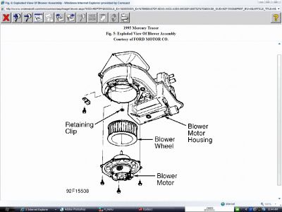

How do I change the blower motor in my tracer

Remove the panel under the glove box, then you will see the bottom of the motor, remove the three screws, and pull it out!
