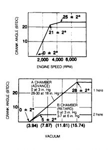

What is the timing supposed to be set to? And what is the throttle position sensor setting?
Thursday, October 23rd, 2008 AT 3:31 AM
ZACKMAN
MECHANIC
4,202 POSTS
2 @ 1000.
TPS:
.5mm Continuity between IDL - TL
.7mm No continuity
WOT continuity between PSW - TL
