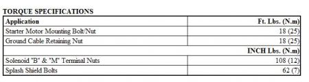

BLUELIGHTNIN6
MECHANIC
16,542 POSTS
Sunday, March 29th, 2009 AT 11:13 PM
