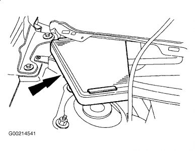

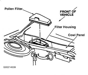

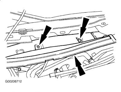

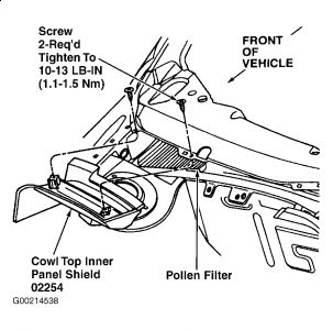

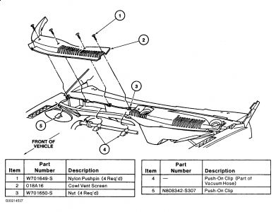

Had my oil change they open the cabin air filter and now when it rains it runs inside of the car how can I fix this?
