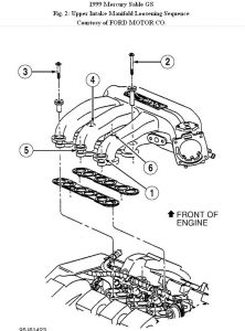

I need torque seguence for upper intake manifold. Need to remove this to put spark plugs in rear of motor. The motor has duel overhead cams.
6 cyl Front Wheel Drive Automatic
Sunday, June 27th, 2010 AT 1:17 PM
KHLOW2008
MECHANIC
41,814 POSTS
Hi tburnside,
Thank you for the donation.
The diagram is removal sequence. For installation, reverse the sequence. Tightening torque is 71 - 106 inch/lbs ( 8-12 N.m ).
