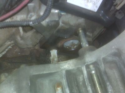

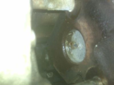

Got the plate off of the side of the engine sort of (only able to pull it out about 3 inches without taking the steering pump off) and there was a freeze plug right behind it and it still was wet. Hooked up air compressor to main radiator hose and had my son cover the other 2 and gave it a slight bump of air and antifreeze shot out of the plug like a super soaker. Next to get that thing out and replace it with an expansion plug I got tonight.
https://www.2carpros.com/forum/automotive_pictures/565401_IMG00437_1.jpg
Will be working on removing the plug tomorrow afternoon after work. Will update how it goes.

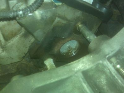

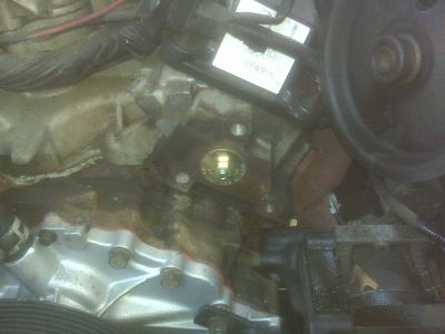

This was an easy fix after the assy plate was completely removed which was not as easy. I am of the firm belief that engine designers should be made to perform these type of repairs to their creations in 95 degree heat at 90% humidity in indirect sun light with minimal tools in a drive way. I do think afterwards they will put more fore thought into these 65 cent parts that they use in critical parts of the engine. Well at least my 18 year old can now safely drive his "baby"...
