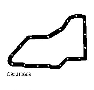

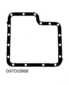

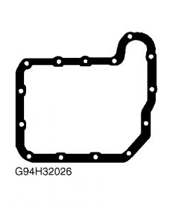

I am trying to figure out how to tell what kind of transmission I have to be able to replace my speed sensor

Look at the oil pan
AX4S
AX4N
C6
CD4E
