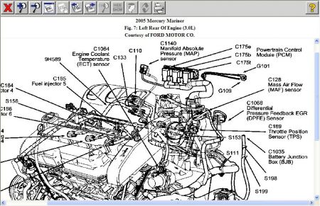

Hi, I recently had my first engine light go on on my 2005 Mercury Mariner (basically a rebranded ford escape). It is a V6. The code was P0106 which has to do with MAP sensor performance. I brought it to the dealer and they told me the sensor needs to be replaced. Unfortunately they wanted alot of money for a $40 part. So I just decided to do it myself. I got the part, however, I am having trouble locating where the MAP sensor is in this car. Can you help?

Hi mannyp and welcome to 2carpros The MAP sensor is at rear of engine compartment on firewall
https://images.2carpros.com/forum/automotive_pictures/12900_map_6.jpg

Thanks for the response. Can you let me know what software you are using that you got that image from? I'm thinking that is may be useful in the future.

You can download it from here-cheap -see bottom of your post and clickit follow the instructions
