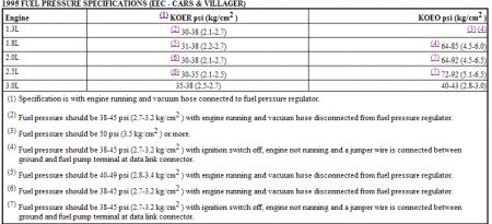

Usually it's on the fuel rail Is this a 2.0 litre?
With Fuel Pressure Gauge WARNING: Always relieve fuel pressure before disconnecting any fuel injection-related component. DO NOT allow fuel to contact engine or electrical components. Remove fuel cap to release fuel tank pressure. Remove relief valve cap. Relief valve is located on fuel supply manifold. Using Fuel Pressure Gauge (T80L-9974-B), release fuel pressure from relief valve (Schrader valve). 1. If fuel pressure gauge is not available, disconnect electrical connector to IFS switch. For IFS switch location, see INERTIA FUEL SHUTOFF SWITCH LOCATIONS table. Crank engine for 15 seconds to reduce system pressure. Turn ignition off. Reconnect IFS switch connector. 2. 5/7/2009 src="https://www.2carpros.com/forum/automotive_pictures/62217_mercb_2.jpg" alt="https://www.2carpros.com/forum/automotive_pictures/62217_mercb_2.jpg" />

I found the fuel line pressure port, and I hooked up a fuel pressure gauge to it, and turned the key to the on position I hear the pump engaging but no change in pressure, im guessing I have a bad fuel pressure gauge, I got the codes checked, and it came back with a bad fuel line code the guy testing it at autozone said it's probably the regulator, I ordered one, also it came back with an auxilary code, he said there's a misfire on 2 and 4 pistons, so im guessing a tune up will fix this, I got the spark plugs and im going to check to see if I have spark if not then i'll replace the cap and rodar distributor. Does this sound like it makes sense?

What were the fuel pressure readings? Did start the car also and re check pressure?

Use the specs I posted...

Yes and the needle, did'nt move at all. Which I assume it would atleast move, the car turns on just fine.

Key on engine off should read 35-45 psi. Have the codes read and post the results please!
