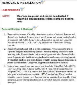

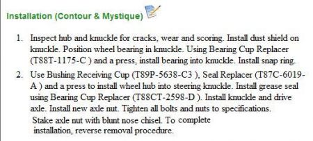

need to know how to replace front bearings on 95 mercury, on hub wheel
Monday, July 5th, 2010 AT 10:12 AM
BLUELIGHTNIN6
MECHANIC
16,542 POSTS
Monday, July 5th, 2010 AT 4:45 PM
