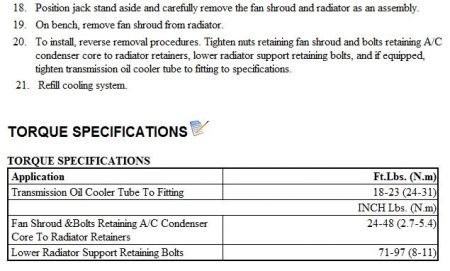

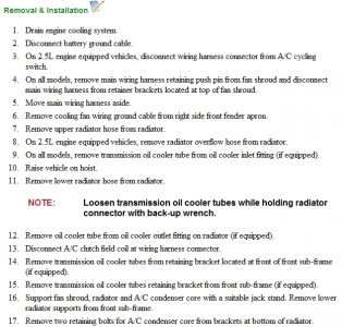

How do I replace the engine cooling fan? Step by step detail on how to do it myself. Thanks
Tuesday, May 18th, 2010 AT 10:24 AM
BLUELIGHTNIN6
MECHANIC
16,542 POSTS
Wednesday, May 19th, 2010 AT 12:09 AM
