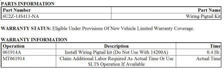

When you jumped the solenoid, was the key in the on position? Wont start unless it is. Security prove out light should blink ever 2-3 seconds with key out, then when you turn the key to on, it will go on steady for a sec or two, then go out. Any aftermarket electronics? Remote start? There is also a known problem at the starter terminal: Reference Number(s): 06-19-14,  Date of Issue:   October 2, 2006 Related Ref Number(s): 06-19-14 ARTICLE BEGINNING ISSUE Some vehicles may exhibit a no crank condition due to an open circuit in the starter relay to starter motor circuit at the starter motor connection. ACTION Follow the Service Procedure steps to correct the condition. SERVICE PROCEDURE A new starter terminal wiring pigtail kit is released eliminating the need to replace the entire harness for the terminal connection. Refer to instruction sheet contained in Wiring Pigtail Kit for wiring harness service procedure. PARTS INFORMATION FORD: 1997-2007 Crown Victoria; 1997-2004 F-150 Heritage; 1997-2006 Expedition; 1998- 2006 E-Series; 1999-2006 F-Super Duty; 2002-2007 Explorer; 2004-2006 F-150; 2007 Explorer Sport Trac LINCOLN: 1998-2006 Navigator; 2003-2005 Aviator MERCURY: 1997-2007 Grand Marquis; 2002-2007 Mountaineer NOTE: TERMINAL KIT ONLY SERVICES THE STARTER RELAY TO STARTER MOTOR CIRCUIT. THE KIT DOES NOT SERVICE STARTER MOTOR BATTERY POWER CIRCUIT. NOTE: REFERENCE THE APPROPRIATE WORKSHOP MANUAL SERVICE SECTION 303-06 FOR REMOVAL AND INSTALLATION OF THE STARTER MOTOR WIRING TERMINAL CONNECTION PROCEDURES.
https://images.2carpros.com/forum/automotive_pictures/62217_Termial_Part_Num_1.jpg
