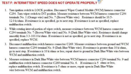

where is the relay for the windsheild wipers located?

Not equipped with wiper relay. follow procedures below if you have issues with the intermittent setting of your wiper system..
