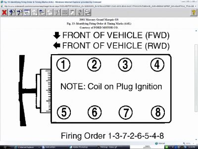

2001 Mercury Marquis V8 65000 miles
My OBD2 diagnosis says "Cylinder 5 Misfire". How do I locate Cylinder 5? My car user manual does not identify.

Here is the firing order diagram... Let us know if you need anything else.
