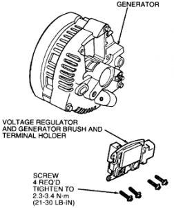

WHERE IS THE VOLTAGE REGULATOR ON A 1997 MERCURY GRAND MARQUIS AND WHAT IS THE CORRECT PROCEDURE FOR REPLACING IT?

Disconnect the battery cables

It is integral with alternater ie. Inside ALT.
