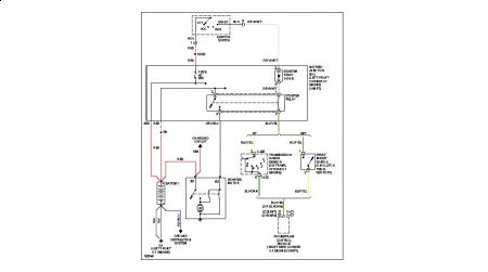

Probable causes: Check the battery and connection, starter, starter relay, starter relay diode, 40 amp fuse and ignition switch.

Electrical problem
2002 Mercury Cougar 6 cyl Front Wheel Drive Automatic
Car wont start but it has power,gauges and lights all work, no clicking when I try to turn the ignition, I tried changing the battery and it did the same thing.
Sep 22, 2020 at 11:07 AM (Merged)
  • 75,992 POSTS
No crank at all/nothing/nada:
Could be the starter, starter relay, clutch switch/park and neutral switch and ignition switch assuming the battery and connections are good.

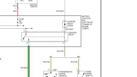

DANYAEL
2000 Mercury Cougar 6 cyl Front Wheel Drive Automatic ???? miles
basically the car wont turn over i changed the battery because it was obviousely no good and the car still wont start when you turn the key forward the electrical is a bit loopy everything electrical still works in the car but it wont start when turned over. when i do try it to start the car it makes a loud clicking sound im at a loss and can not figuire out whats going on so if you have any suggestions please let me know.
Sep 22, 2020 at 11:08 AM (Merged)
  • 75,992 POSTS
Do you mean it cranks over and refuses to start or it won't crank over at. Have helper hold key at start postion-you find the starter and bang on it-if it kicks over-replace the starter-Don't kick over-check for power at gray/white wire at starter-No power check the transmission range sensor/starter relay/ignition switch-

Replaced battery and altenator but car still won't crank.Where is the fuseable link located & what does it look like?
Sep 22, 2020 at 11:09 AM (Merged)
JDL
  • 16,098 POSTS
Do you have a theft system on your vehicle? Do you think the theft system might be causing a problem?
Have you done any testing at the starter relay in the battery junction box? Any testing, make sure the tranny is in neutral and the e-brake is set. The ground for the control side of the relay goes through the clutch switch then to the computer. I'm not sure if the computer actually grounds that circuit or monitors that circuit? Without a ground, the relay won't energize.
I can't talk to you about bypassing the relay, because of safety issues.

JDL
  • 16,098 POSTS
The terminal for the load side of the relay is hot all the time. You can unplug the relay, use a test lite, check for voltage. The voltage for the control side of the relay, goes hot when you turn the key to crank.
If the relay has a diagram on it, the load side the symbol may look like an open switch, for the control side of the relay, the symbol may look like a coil.
Have a helper turn the key to crank, can you hear or feel the relay click? I think you would still need to check voltage on the load side.
If the theft system is causing a problem, even if you get the starter to crank by testing. It won't start.
