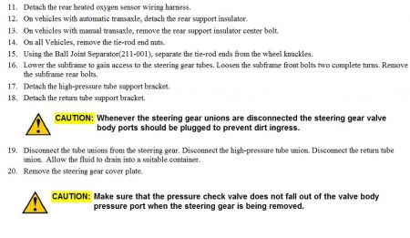

i can't get the old inner tie rod out? Any advice

Steering gear must be removed before you can remove tie rod, have you removed it yet?

Ow do I do that

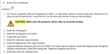

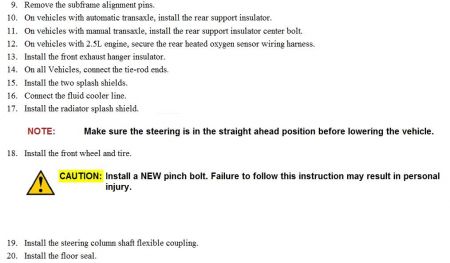

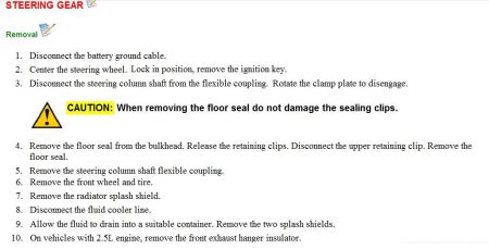

It is a rather in depth repair so i have posted steps below to help you through
