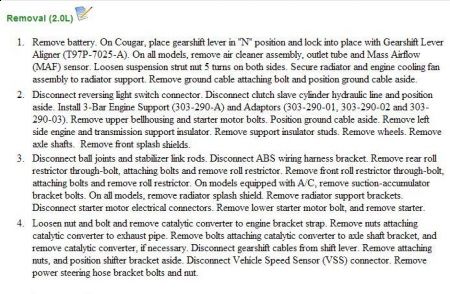

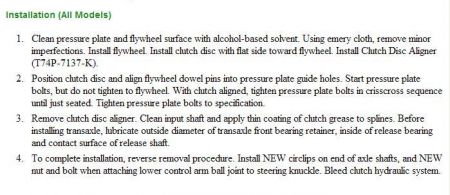

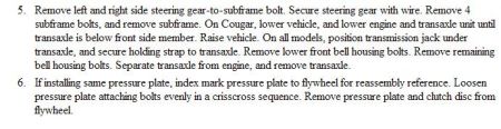

How do I drop the tranny?
Saturday, November 7th, 2009 AT 12:30 PM
BLUELIGHTNIN6
MECHANIC
16,542 POSTS
Saturday, November 7th, 2009 AT 4:58 PM
