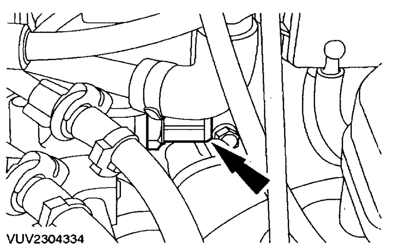

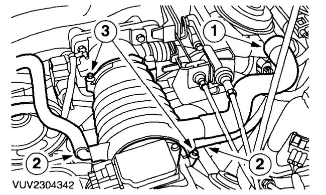

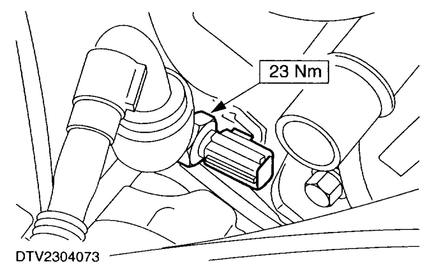

temp gauge reads in red but engine no hot.I changed the sending unit water pump and 2 thermostats plus had system flushed out
Tuesday, August 19th, 2008 AT 3:14 PM
10 Replies
BLUELIGHTNIN6
  • 16,542 POSTS

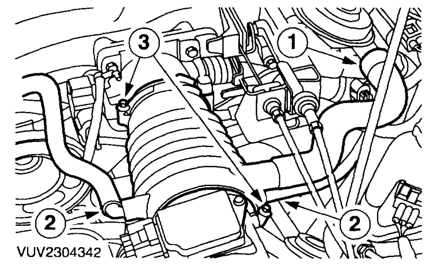

It is more than likely the engine coolant temperature sensor. It seems to go out on several of the 1999 - 2000 cougar models.
1. Drain the cooling system.
2. Remove the air cleaner outlet tube.
1 Disconnect the intake air bypass hose.
2 Disconnect the positive crankcase ventilation hose.
3 Remove the air cleaner outlet tube.
3. Disconnect the Engine Coolant Temperature (ECT) sensor electrical connector.
4. Remove the ECT sensor.
INSTALLATION
1. To install, reverse the removal procedure.
2. Fill the cooling system, as required.
Corresponding pictures are attached below

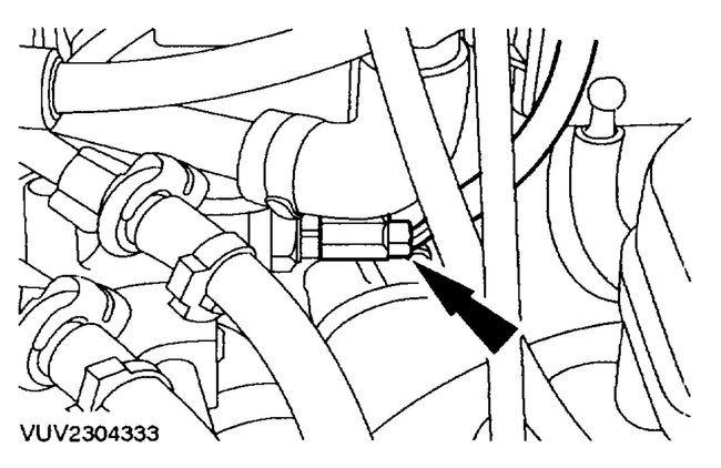

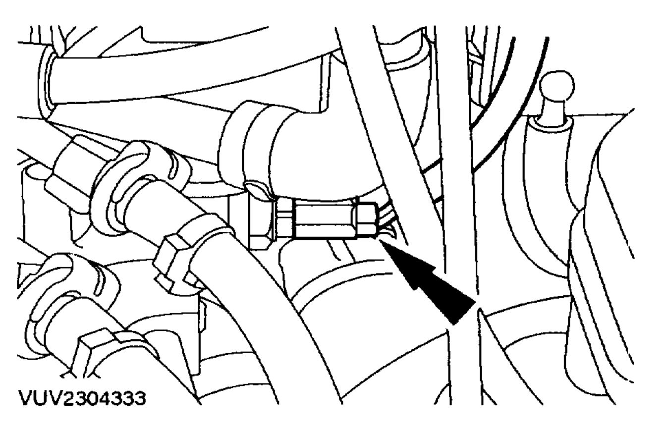

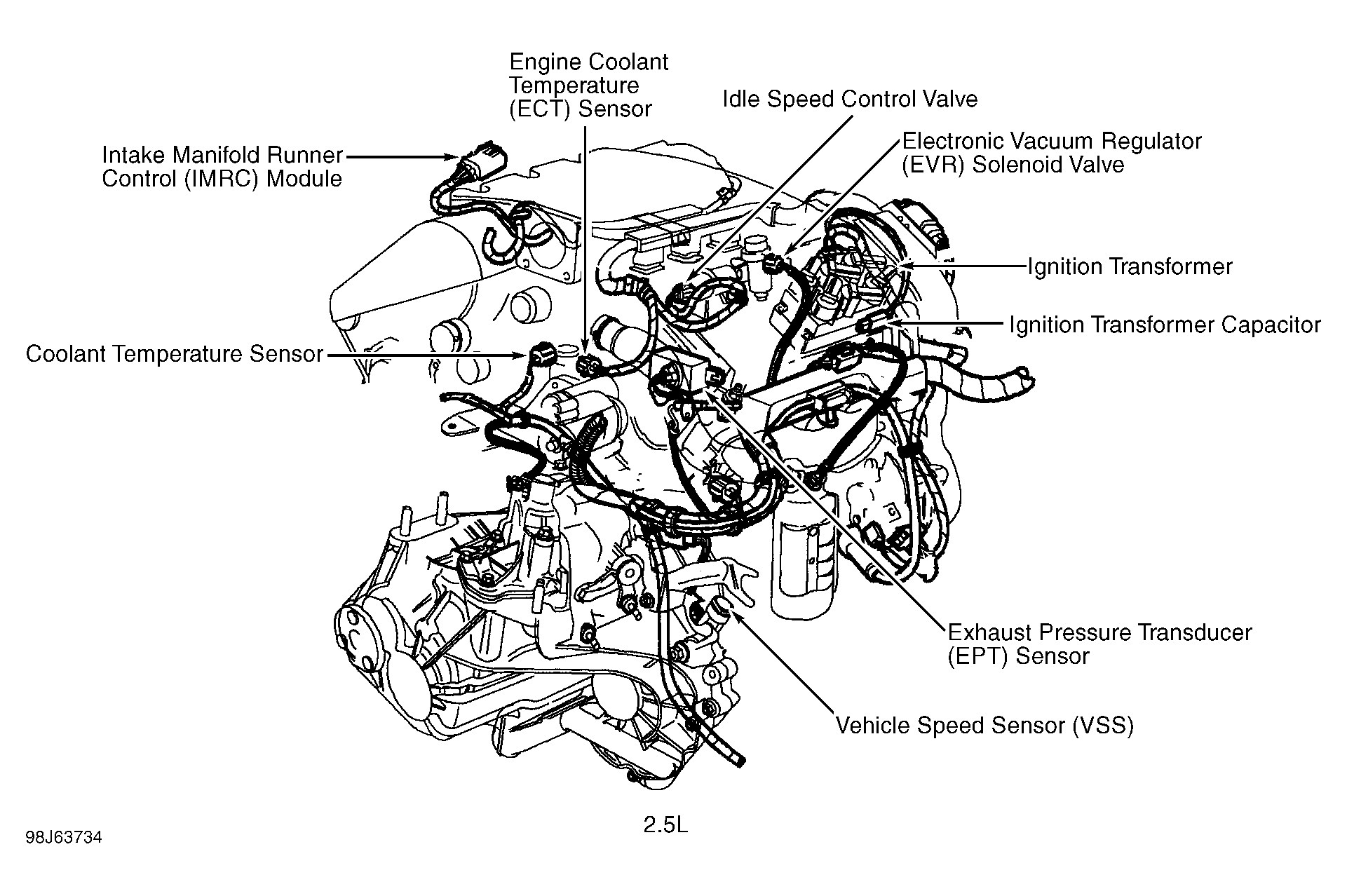

They sent me to the pros. I need help can you guys tell me where the temperature gauge sender/sending unit/temperature gauge switch is located on a 01 mercury cougar v6 s model 2.5 litre. My ac heat & ac works fine. But when idling the gauge goes to the red area and comes back to the middle position when the fans kicks in. I was told the car has 3 sensors I changed the 2 coolant sensors. The sensor im looking for is threaded on both sides it looks like it goes to 1 wire. I really need to locate the temp gauge sender or sending unit HELPPPP I also included a picture of the part
+1
Wednesday, December 5th, 2018 AT 5:09 PM (Merged)
CJ MEDEVAC
  • 11,005 POSTS
I think your question was hiding
I stumbled over it. Not by accident!
This diagram may help
Let me know if it does
The medic
