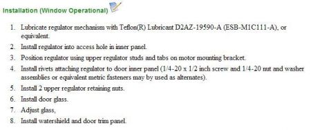

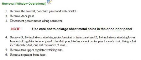

i need help changing the regulators. Theres nothing in my haynes manual thats of any help.
