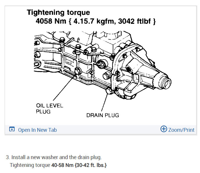

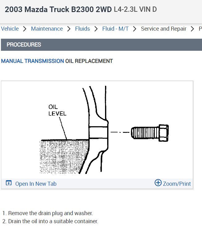

Or, or you can just do it yourself, here is a guid to show you how with images below to help you as well.
https://www.2carpros.com/articles/how-to-service-a-manual-transmission
Fluid Types
Specified oil grade .................... MERCON or M-111
Capacities
Capacity .................... 2.65 liters { 5.6 US pt. 4.5 Imp pt }
Check out the images (below). Let us know if you need anything else.
