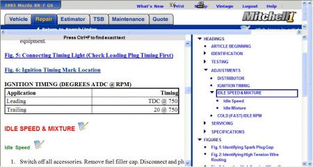

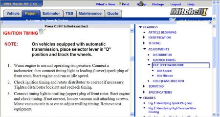

I was wanting to know how to time my rx-7 I turn the cap and it acts like it wants to be in time but im not sure where it needs to be at and I dont want to mess it up

See below
