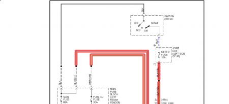

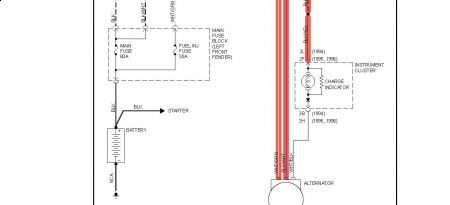

We changed the alternator in my husbands 96 mazda protege and the battery light will not shut off. Why doesnt the alternator keep charge after we installed a new one?

Hi karen8686 and TY for the donation
Check all these fuses, main fuse 80amp, fuel inj fuse 30amp and meter fuse 15amp if these fuses are okay-double check connection behind the alternator- test the wiring to the ignition switch and also the charge indicator-Also see below EWD unable to read it give me your email addy
https://www.2carpros.com/forum/automotive_pictures/12900_a1_1.jpg
https://www.2carpros.com/forum/automotive_pictures/12900_a2_1.jpg
Sunday, November 22nd, 2009 AT 2:20 AM
