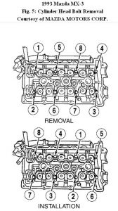

What is the torque I need when installing a cylinder head

Hi jay6oss,
Step 1 = 17 - 19 ft/lbs. (23 - 26 n.m)
Step 2 = Additional 85 to 95 degrees.
Sequence are as indicated in diagram.
