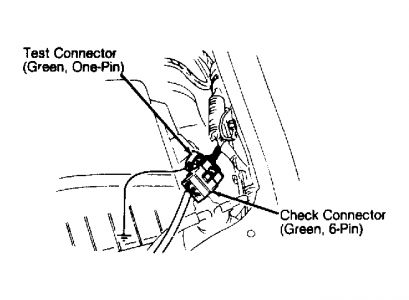

Locate test connector left front engine compartment see diagram

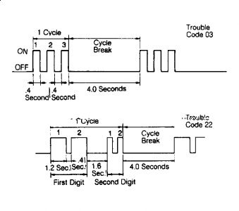

With jumper wire ground connector turn key on count pulse of dash MIL light see diagram
https://www.2carpros.com/forum/automotive_pictures/198357_Grafic_3_77.jpg
Post codes will advise
