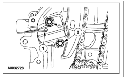

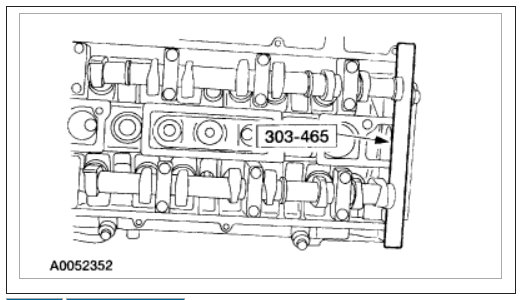

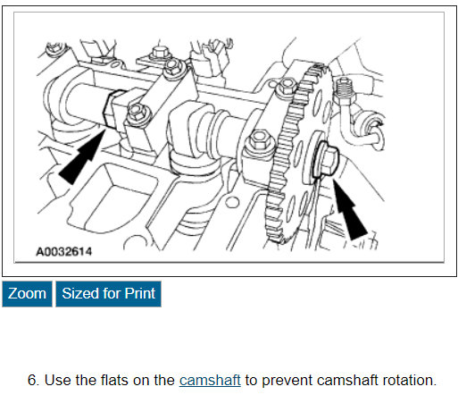

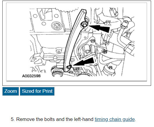

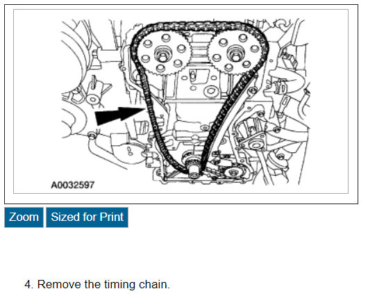

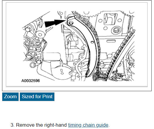

You engine has a timing chain there are no marks you use a special tool to align the camshafts.
Cheers
