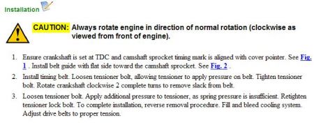

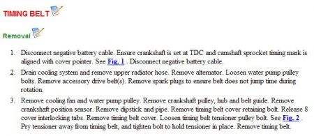

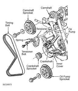

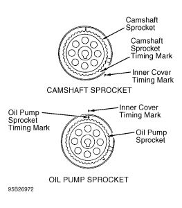

How do I change the timing belt?
Saturday, August 22nd, 2009 AT 7:55 PM
BLUELIGHTNIN6
MECHANIC
16,542 POSTS
FIG. 1
FIG. 2
-1
Saturday, August 22nd, 2009 AT 11:20 PM
