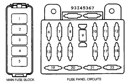

what is the fuse diagrams for my truck?
Saturday, January 31st, 2009 AT 11:26 PM
BLUELIGHTNIN6
MECHANIC
16,542 POSTS
UNDERDASH FUSE PANEL IDENTIFICATIONS (ALL MODELS)
