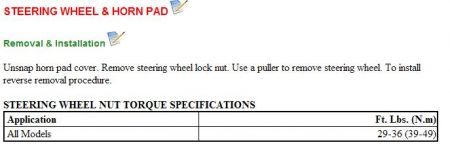

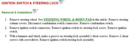

How do you remove the ignition lock cylinder for replacement?
Thursday, February 18th, 2010 AT 10:11 PM
BLUELIGHTNIN6
MECHANIC
16,542 POSTS
-1
Thursday, February 18th, 2010 AT 10:23 PM
