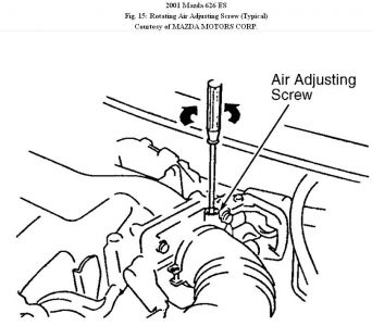

Is there any way to adjust the idling on a 2001 Mazda 626? When I’m stopped at a light the car shakes from low idling.

Hi John, Diagram shows where the idle adjust screw is located.
https://images.2carpros.com/forum/automotive_pictures/192750_IdleAdjust01MAzda626Fig15_1.jpg
It might require some cleaning together with the throttle body.
