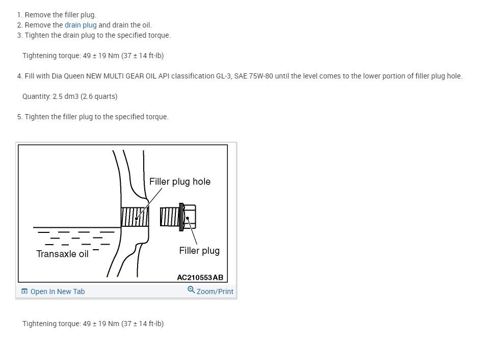

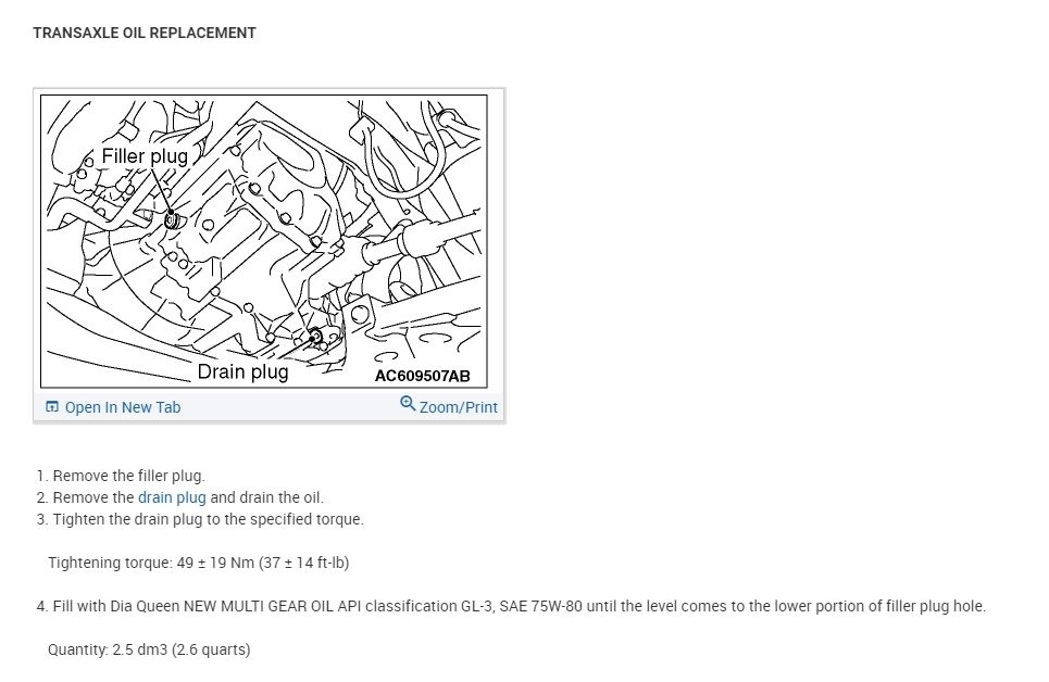

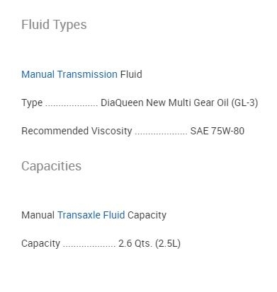

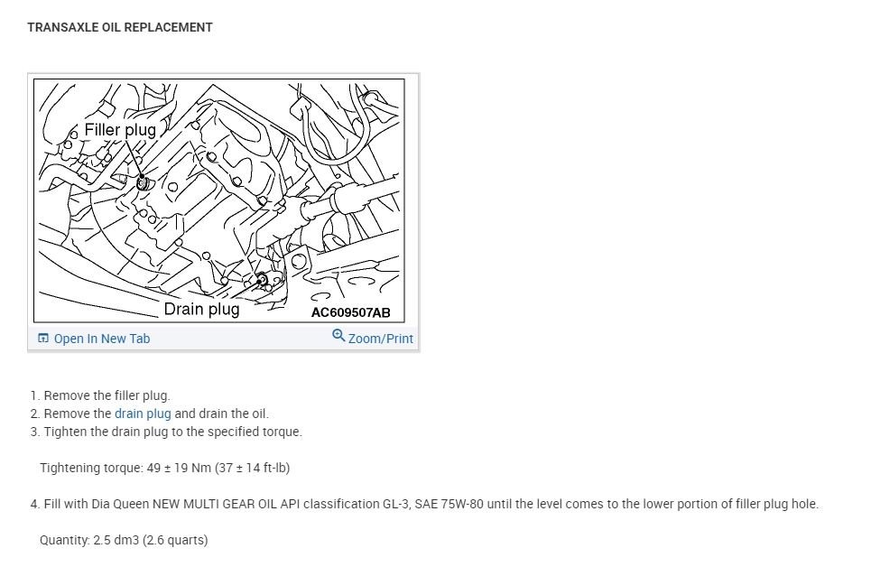

It sounds like the oil itself. What brand and viscosity oil did you use for the repair? I attached the specs below along with the procedure. Check out the diagrams (below). Let us know what happens and please upload pictures or videos of the problem.

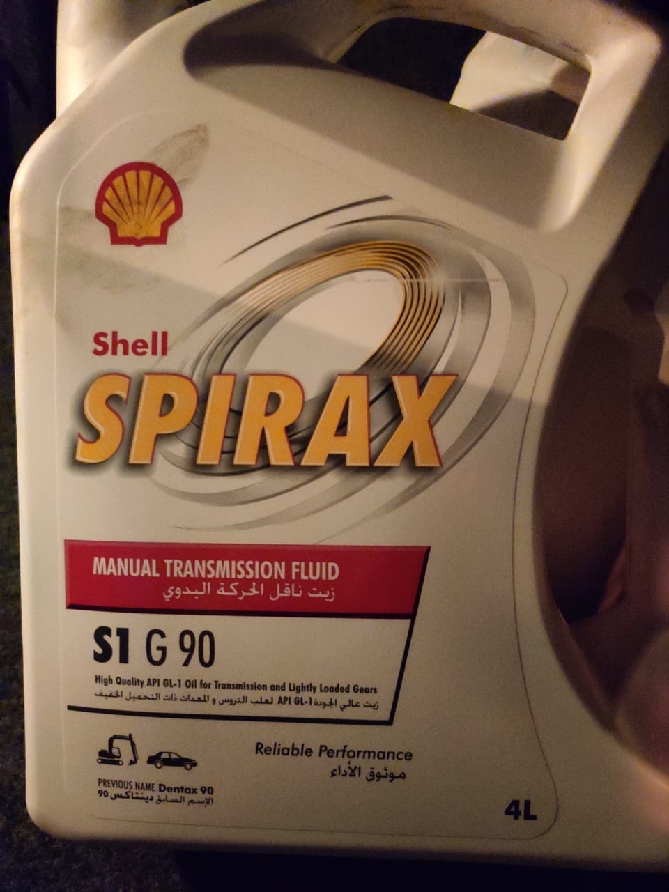

Dear Roy, I saw your attached files regarding my car and found out that I put on my car the wrong gear oil so, I guess it's why my transmission is doing this kind of issue.
instead of "75W-80 Gear + GL-3" oil type, I put on "SI G-90" from Shell CO.

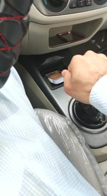

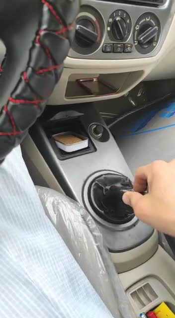

Please Roy, check the attached video and photos as you requested so.
From the video you could just realize that the transmission is stuck/cannot change to the other gear.

I would replace the fluid with the correct fluid and see if it helps it any before we talk about damage to the transmission itself.

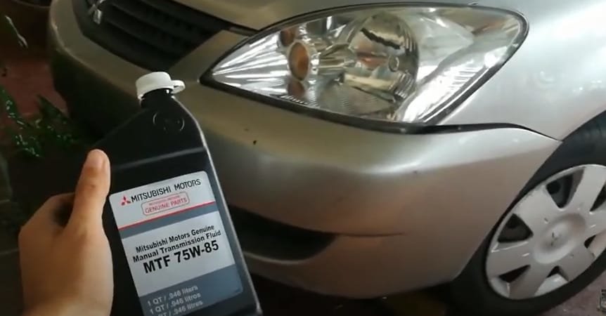

in my country, I didn't find the right fluid for my Mitsubishi Lancer car MTF.
The company itself doesn't have it.

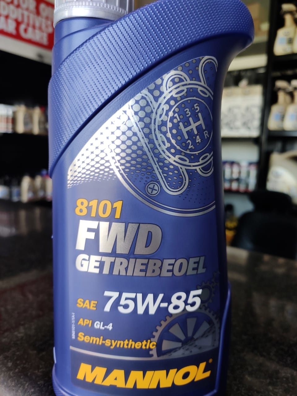

However, I found another company (Mannol) having the same grade as required which is 75W-85 but its API GL-4. and mine should be GL -3. Can I use this one for my gear instead?
Check the attached photo of the fluid.
Thanks
Jan 17, 2022 at 11:30 PM
Yes, you must use a minimum of GL-3. The 4 is better, so yes. You could not use anything less than GL-3.

Can you please elaborate more? What does GL-3 and 75W-8085 stand for??
in the manual it says GL-3 and 75W-80, but the available right now is GL-4 and 75W-85.
please have a look at the photo attached below.
Many thanks
Jan 18, 2022 at 5:57 AM
GL4 is better than GL#. That is good.
75w-85 is the weight of the oil, both hot and cold.
Those specs are critical for the proper operation of the shifting.
