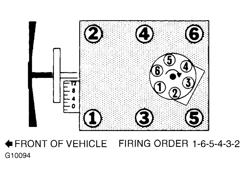

Timing should be at 0 not 2 retard for one thing. Recheck firing order see pic
Tuesday, September 1st, 2015 AT 6:48 AM
COMER
Hi checked firing order ok returned to zero still low when hot thx
