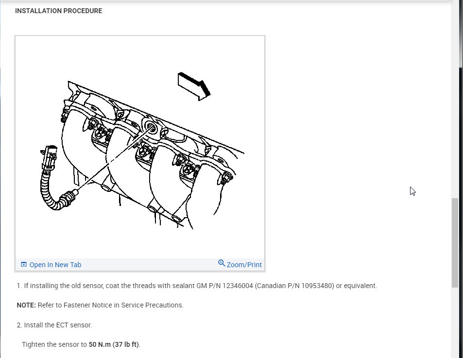

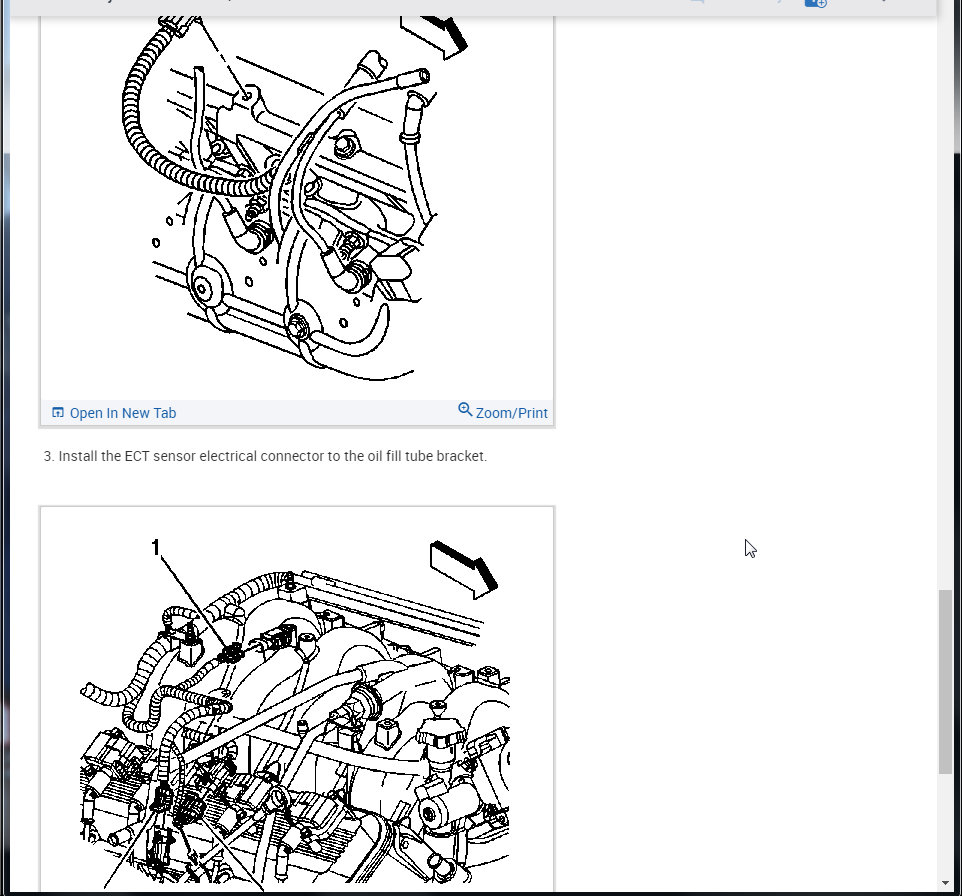

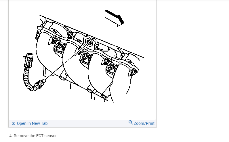

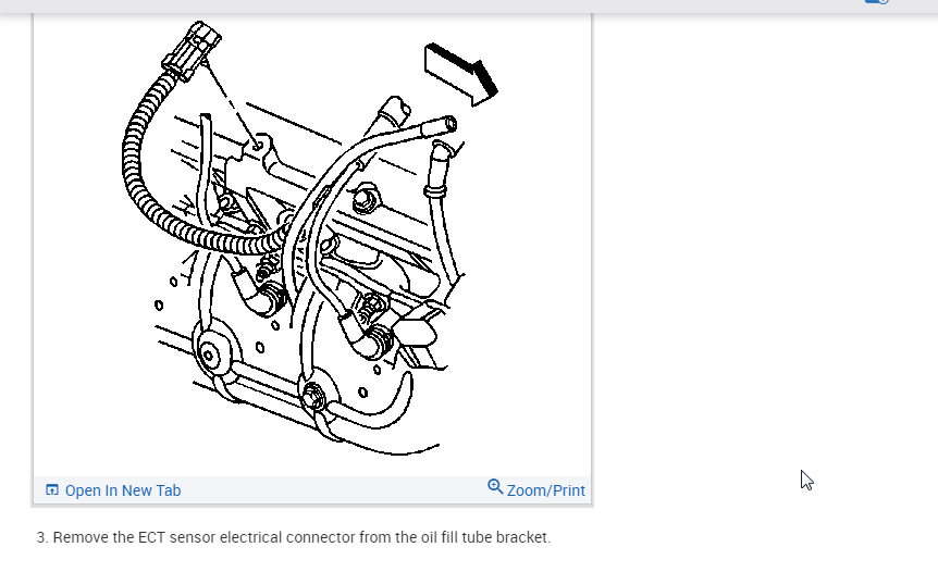

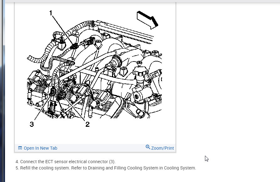

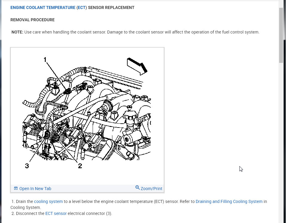

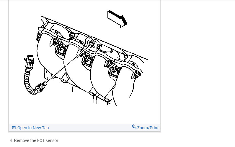

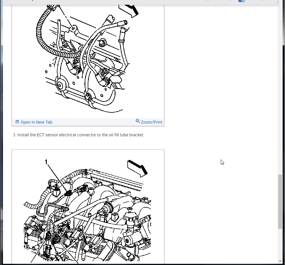

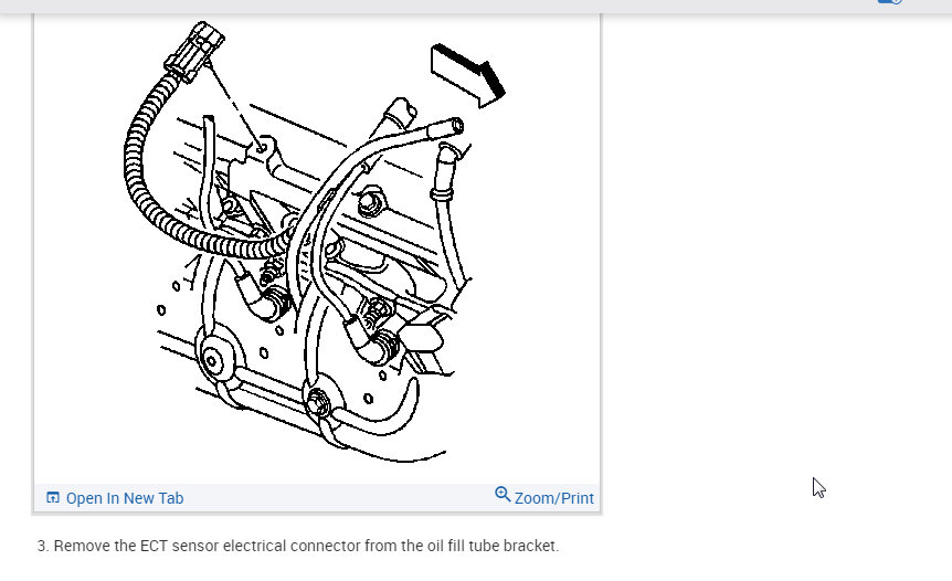

I need to install a temperature sending unit and cannot locate it on my SUV 2500 listed above.
Saturday, July 11th, 2020 AT 12:31 PM
I assume you are referring to the engine coolant temperature sensor. I attached the procedure for this. Let me know if there was something else you had in mind. Check out the diagrams (Below). Please let us know if you need anything else to get the problem fixed. Thanks
