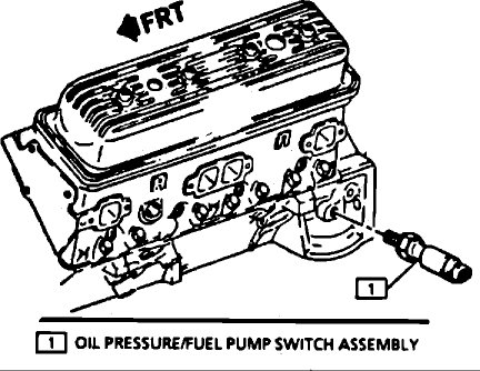

I need to know the location of temperature switch and oil switch.
Friday, December 1st, 2017 AT 1:22 AM
3 Replies
PATENTED_REPAIR_PRO
  • 1,853 POSTS
On G series vans the oil pressure switch is located drivers side rear of engine.
The temperature switch is drivers side of engine. Here are diagrams for both:
The oil pressure switch shows 2 possible locations so look at both.

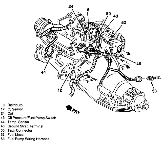

Thank you I have located the oil pressure switch I need to know the location of the temperature switch not the temperature sensor from what I understand the temperature switch is feeding to wire feeding the computer and the temperature switch is for the temperature gauge I need to know the location of the temperature switch thanks
Friday, December 8th, 2017 AT 6:54 PM
PATENTED_REPAIR_PRO
  • 1,853 POSTS
Try this, this shows 2.
