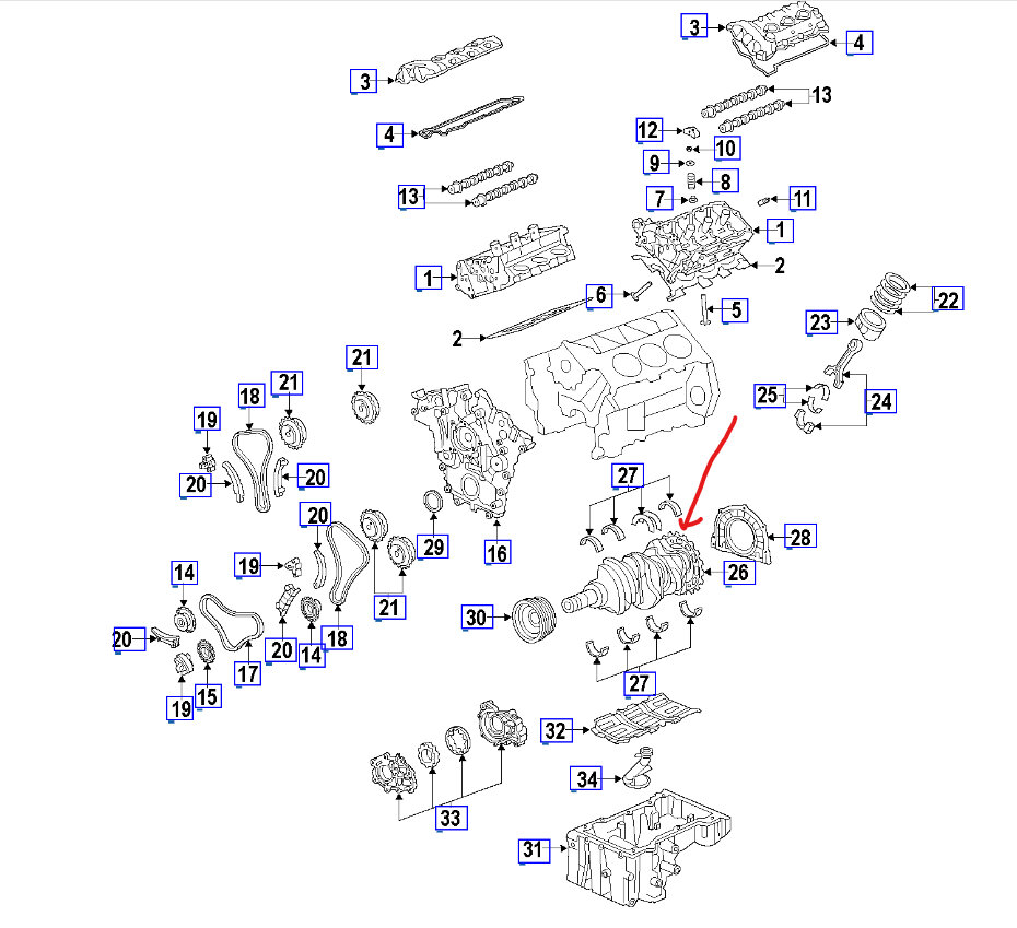

I am needing to know the location for the vehicle listed above.

The engine crankshaft is in the center of the engine block down low. Check out the images (below). Let us know if you need anything else.

Is that on top of the transmission next to the rack and pinion or back behind the exhaust manifold? Do you have a key for the diagram you sent before?

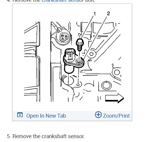

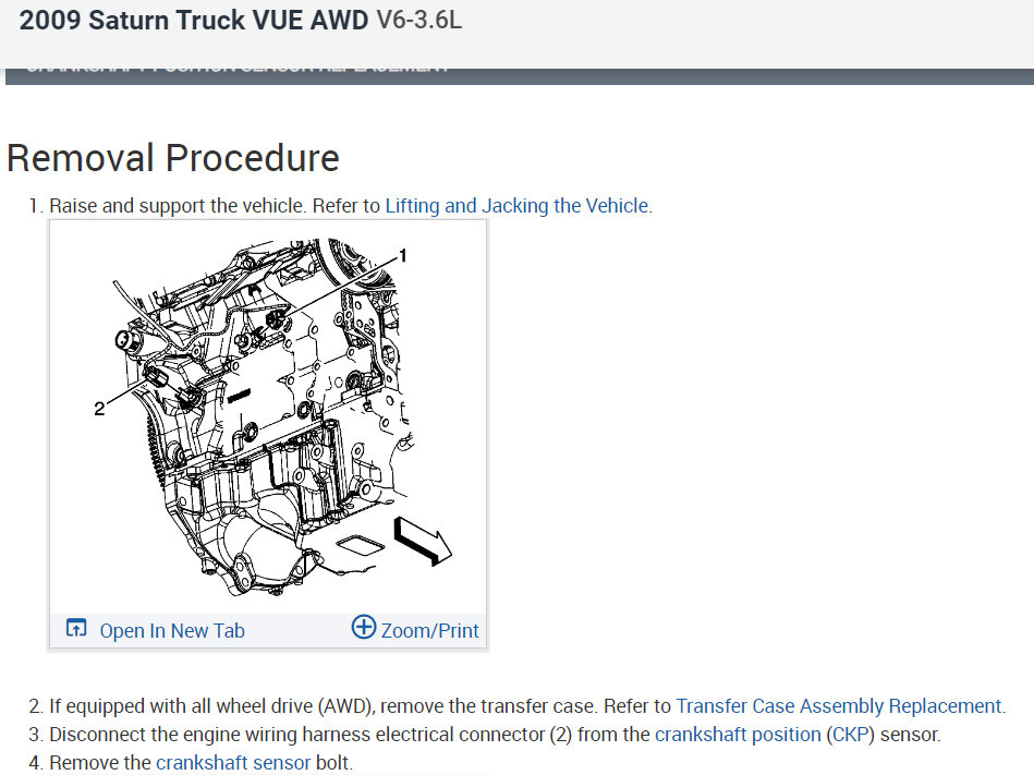

Are you talking about the crankshaft angle sensor? If so this is the location of the sensor. Check out the images (below). Let us know what you find.
