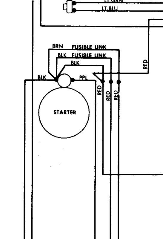

Replaced the starter3 time s. Need make sure my wireings correct and also anything else that won't let it crank over

Check the fusible links that bolt to starter they are brown or black then go to a different color wire. Make sure the flywheel teeth aren't all ground down and you are getting correct starter. Purple wire goes to "S" terminal on solenoid.
