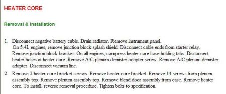

I am trying to change the heater core in my car but I do not know where to find the heater core

Behind passenger side dash. Below are correct procedures for replacement..
