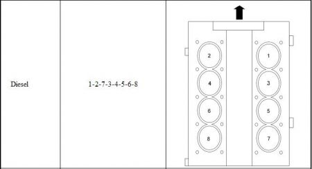

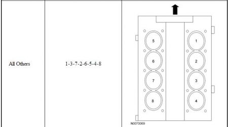

Where is the number 3 cylinder on a 1998 Lincoln continental 4.6 v8
