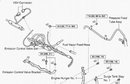

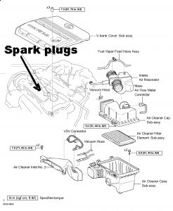

Hi, you very kindly replied to my original question regarding the above procedure. I followed your instructions&drawing, removed the engine cover & found&removed the front 3 spark plugs. But I was completely stumped as to how&where I could find the rear 3 spark plugs. There was an aluminium tube above the area with a pipline secured by a union on the r/h side of the tube. Do I have to remove these items toi get to the rear spark plugs? Would appreciate your expetise on how to continue. Best wishes, Gwenda.

Can you upload a picture for me? On the back side, go to Lexus and buy the tune up kit, you need to remove the surge tank...on American cars it's known as the upper intake...

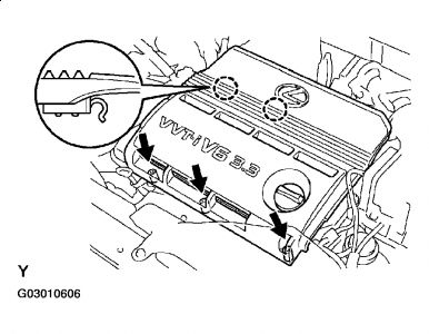

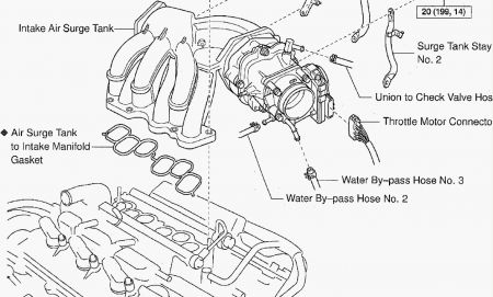

Hi, could you please inform me how to change the spark plugs on my V6 engine. A drawing of how to find them would be very helpful. Many Thanks.

This engine has coil on plug ignition, so each cylinder has a coil on top of the sprak plug, the small screw in each COP is removed(loosened) and the COP is lifted, then using a 16mm socket the plug is removed, new plug(gapped to 1.0mm) is the inserted into the cylinder and tightened. COP is then placed on the plug and the screw retighted. Repeat this for all 6 plugs, reinstall engine cover and you are done.

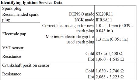

According to Lexus 120K miles here is a guide that will walk you through changing them and the plug part numbers as well
Recommended Spark Plugs
DENSO .................... SK20R11
NGK .................... IFR6A11
https://www.2carpros.com/articles/how-to-change-spark-plugs
