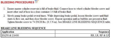

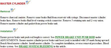

we need step by step instrutions on how to install a non traction controll master cylinder
Tuesday, December 9th, 2008 AT 12:49 AM
MHPAUTOS
MECHANIC
31,937 POSTS
Hi there,
Brake master cylinder r & r and bleeding.
