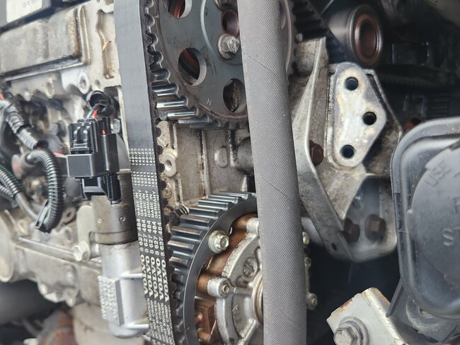

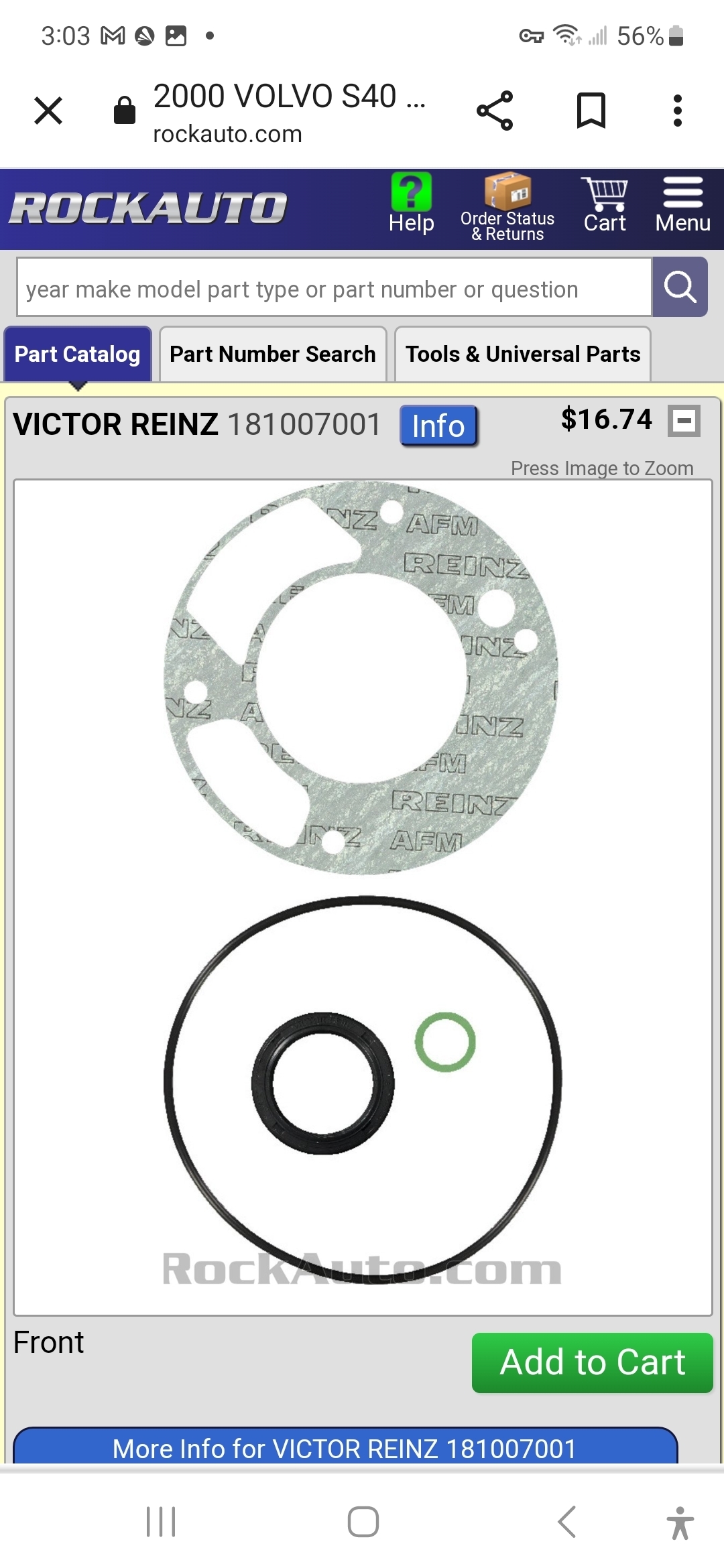

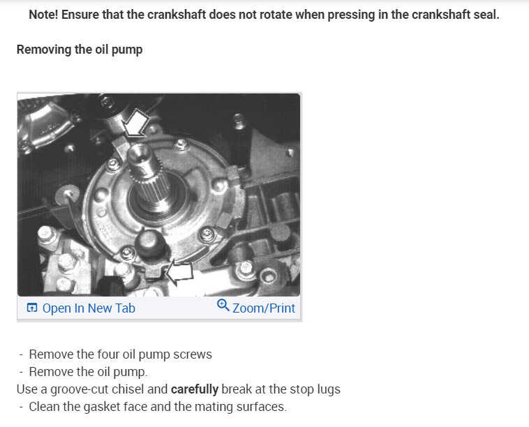

There is oil coming out inside the timing belt cover. I believe it to be the seal behind the crankshaft gear. My question is regarding the plate/housing behind the gear that the seal presses into. It appears to be separate from the block so is there a gasket or o ring that could be leaking behind the plate? Here's one seal kit that is offered and it appears to have a gasket and 2 o- rings. I'm not sure if it's for the 1.9T or not. Could be for the base 2.0.

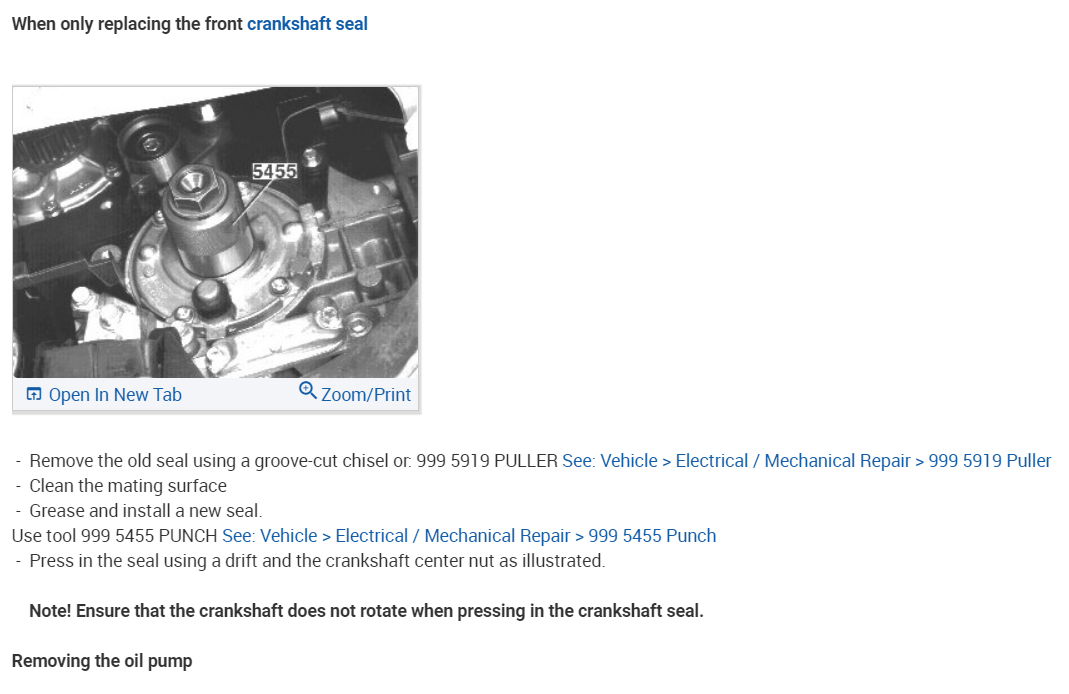

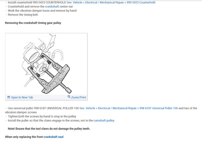

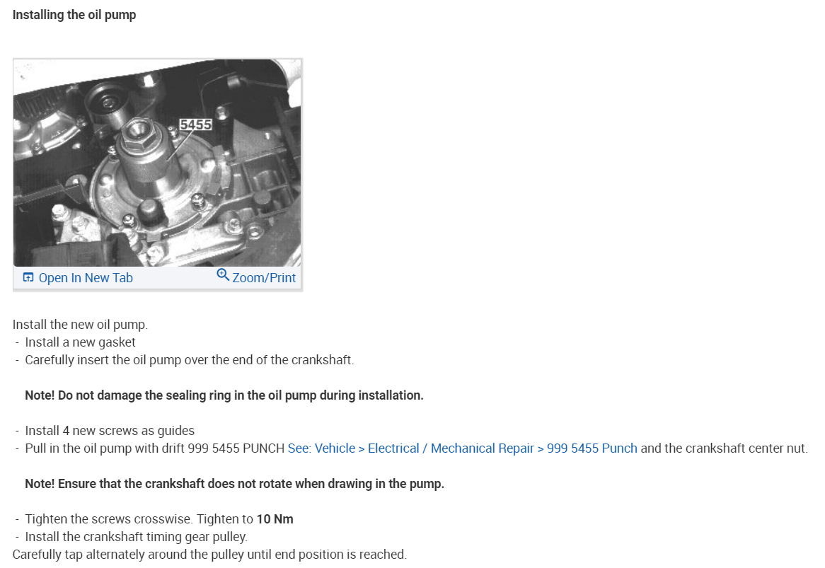

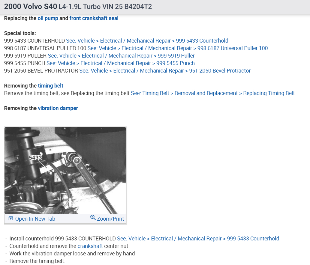

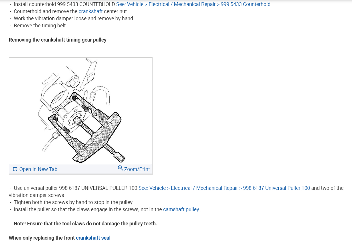

Yes, there is an oil pump on the front of the crankshaft. Here are how the seals are replaced. Check out the images (below). Please let us know if you need anything else to get the problem fixed.

Here's where it stands. I have the oil pump back in with a new O-ring, gasket and small rubber ring that I'm assuming fits over the round protrusion on the inside of the oil pump. There wasn't one when I removed it. The gasket was very brittle and burnt. The intake cam did move backwards a little, after the belt was off, for some reason while I was using a puller on the timing gear. It is what it is, and I don't see how this is any different than any other interference engine. Both cams spring on the CRV when the chain is off. Like you said the timing gear can only go on the crank one way. The balancer can only go one way. All the marks are lined up and I rolled it over several times by hand and there was no resistance other than compression. In the photos you'll see two red marks on the timing gear and the marks on both cams. With everything lined up #1 is nowhere near TDC. I'm afraid to fire it up. Normally timing is set with #1 at TDC.

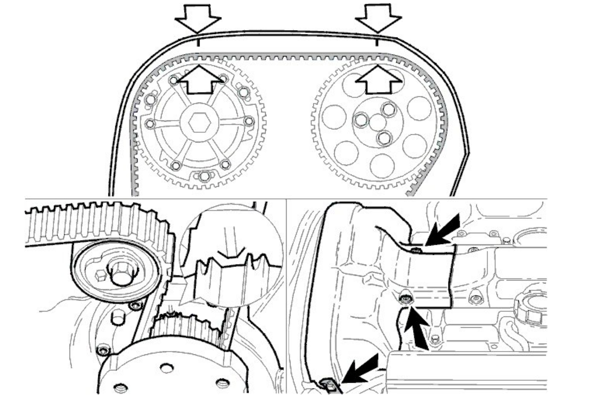

Okay, here is how the timing marks are to be lined up, please double check to see if everything is aligned correctly. Check out the images (below). Please let us know what happens.

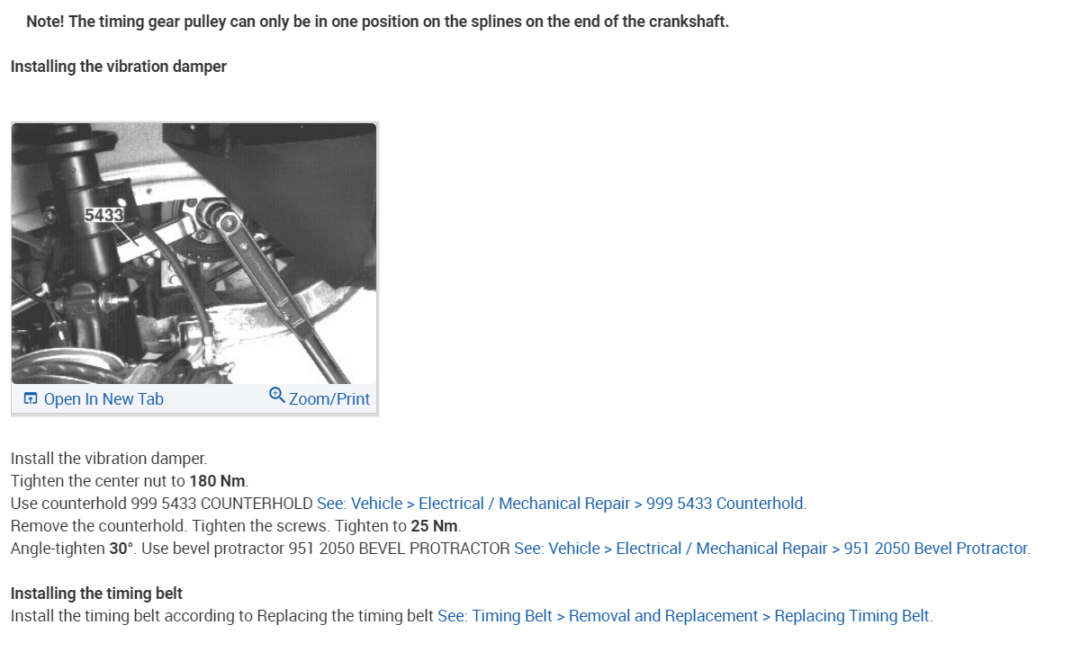

That's exactly how it looks in the photos I sent. Were you able to see the red lines on the timing gear and in the other photo the cam marks lined up as they should with the notches in the top cover. Now my problem is trying to get the crank nut to 133 ftlbs and the 4 bolts on the balancer to 44 ftlbs. I'm afraid to go that high. It seems like they will snap. Those are the specs though according to Volvo.

Can I ask how you are holding the crankshaft from turning when you tighten the bolt?
Tuesday, August 22nd, 2023 AT 10:28 AM
JEFF HERMAN
  • 486 POSTS
I placed a maple block at an angle against the teeth to jam the cam gears. Necessity is the mother of invention.

JEFF HERMAN
  • 486 POSTS

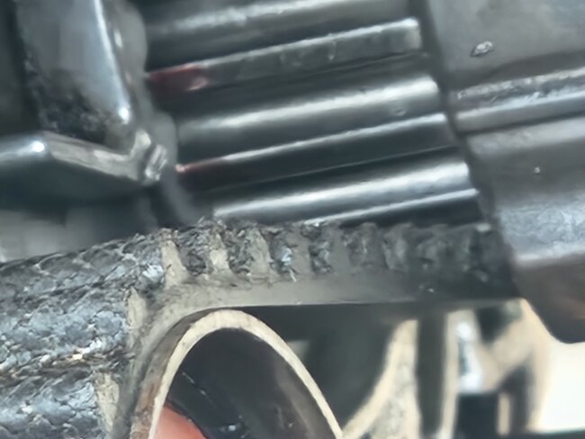

It worked but then I was double checking it and it must have slipped but the belt broke. Lol. It was probably weak from oil saturation or age and needed to be replaced anyway. I had to remove the balancer again to put the new belt on and this time I used a bolt in one of the balancer mounting holes and a pry bar up against the control arm. I was able to hit torque spec and only bend the bolt a little. It was only grade 3. It's back together now and I'm waiting for a serpentine belt this afternoon. It turns over freely by hand and stays in time. Better yet the spark plugs are out and with the coils sitting on top I can see both valves in each cylinder working. Hopefully it will fire this evening or tomorrow morning. After all this there's a good chance the leak is from the VVT on the exhaust cam. Hope not. That one looks fun. Somehow have to lock the cam, I think. It's always something. Laying on the ground is the bad part but having to wear readers to see up close is worse.

I don't think the bolt is too tight if it is at 15 ftlbs. There is no easy way to get the timing marks back on expect to take it apart to have the marks line up. Also, it might be a problem by holding the engine still while tightening the dampener. They make a special tool that will hold the dampener while tightening. Here is one for $60.00:
