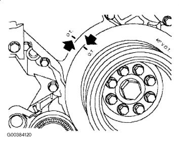

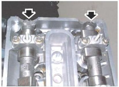

2005 range rover hse,changed head gasket and now i got to do the cam timing witch is difficult but dont really kno how to do it ryt!...is there a link you can send me to see how its done or anything?....ANYYYYY ONE HELP

rotate camshafts until letter and cylinder number markings located on rear of camshafts are in an upright position.
https://images.2carpros.com/forum/automotive_pictures/261618_Noname_1026.jpg
rotate engine crankshaft pulley clockwise to align TDC timing mark.
https://images.2carpros.com/forum/automotive_pictures/261618_2_65.jpg
