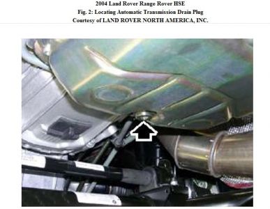

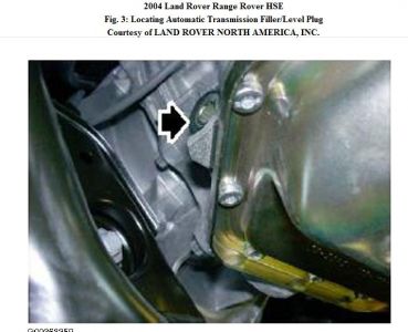

Is there a specifc way of replacing the old transmission fluid for my 04 RR-HSE? Its a 4.4 Eng and I recently called the dealership and they said it must be done every 10 years, or 100, 000 miles.
But since I recently replaced everything else and my vehicle is at 85,000k, I figure I do it now. I did everything needed, except the actual transmission fluid. What are the proper steps to replace the ATF, filter, and gasket?
Thanks

AUTOMATIC TRANSMISSION FILTER Removal Drain automatic transmission fluid. See DRAINING & REFILLING . Remove nut securing selector lever to automatic transmission selector shaft and release lever. Remove 2 bolts securing inhibitor switch guard and remove guard. Evenly and progressively loosen and remove 22 Torx bolts from oil pan. Remove oil pan and discard gasket. Remove 2 Torx bolts and remove oil filter from valve block. Discard "O" ring. Automatic Transmission Drain Position vehicle on lift. Apply handbrake and position chocks under front and rear wheels. Position container under automatic transmission. Clean area around drain plug. See Fig. 2 . Remove drain plug and discard sealing washer. Allow fluid to drain. Clean sump drain plug, fit NEW sealing washer and tighten to 25 N.m (18 lbs. ft.). Refill Clean area around filler/level plug. See Fig. 3 . Remove filler/level plug and discard sealing washer. Add 7.4-8.5 Pts. (3.5-4.0 L) of correct fluid through automatic transmission level/filler hole. See RECOMMENDED FLUID . Fit NEW sealing washer and tighten filler/level plug to 35 N.m (26 lbs. ft.). Check and top-up fluid level. Fig. 2: Locating Automatic Transmission Drain Plug Courtesy of LAND ROVER NORTH AMERICA, INC. Fig. 3: Locating Automatic Transmission Filler/Level Plug Courtesy of LAND ROVER NORTH AMERICA, INC.
https://images.2carpros.com/forum/automotive_pictures/266999_hse_1.jpg
https://images.2carpros.com/forum/automotive_pictures/266999_hse2_1.jpg
