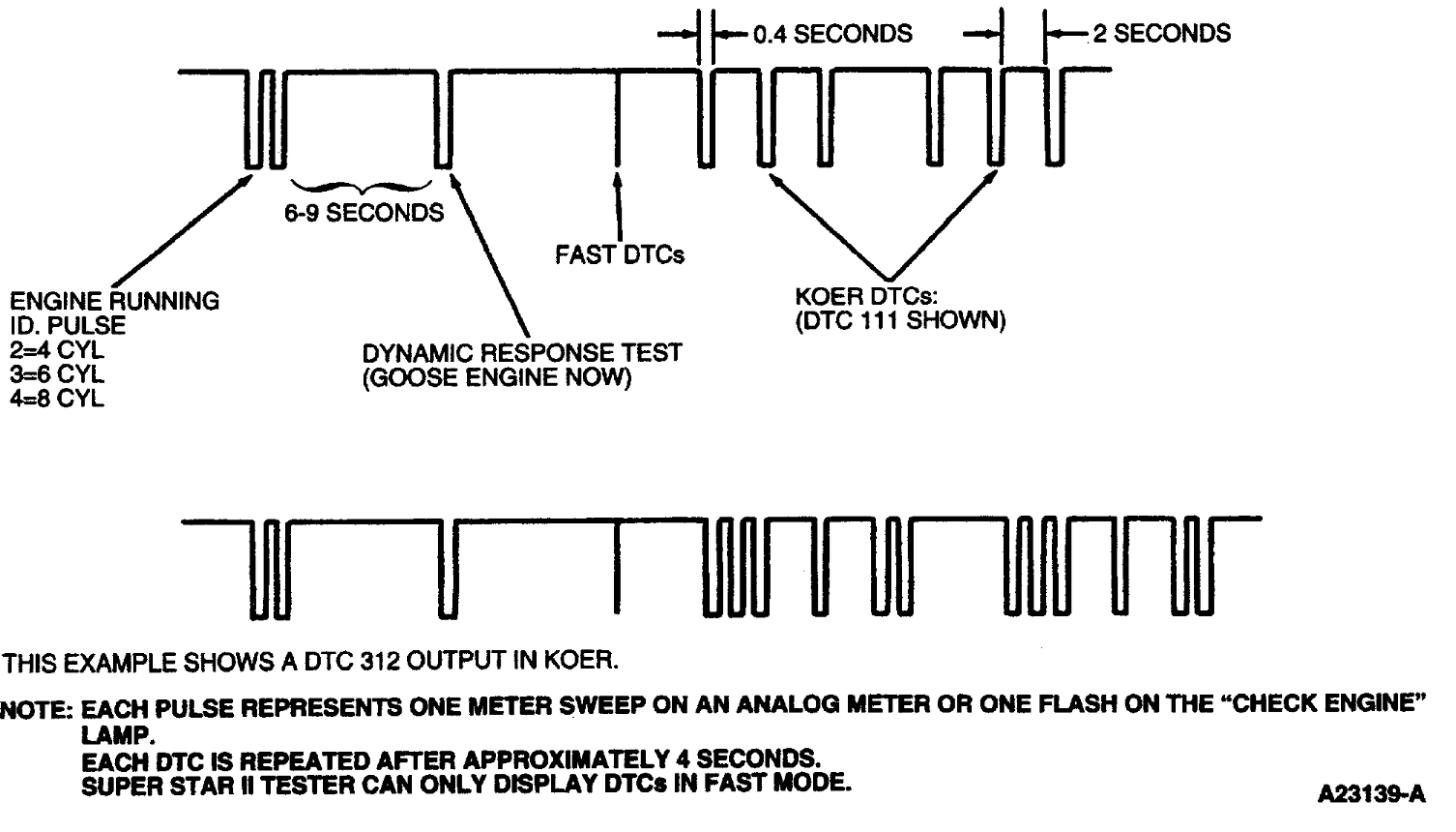

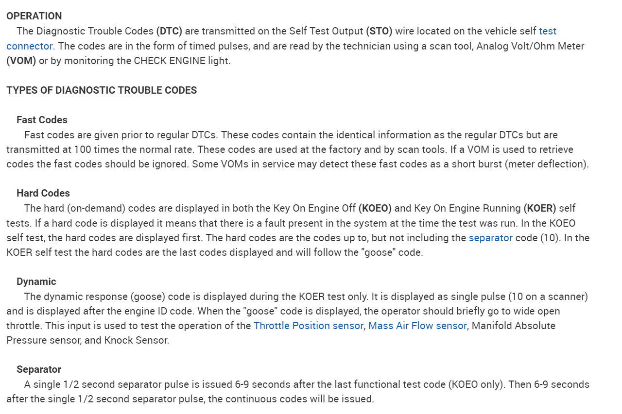

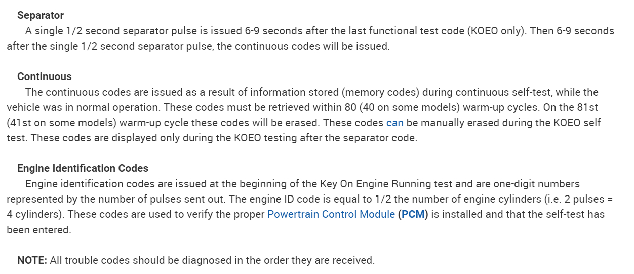

SCGRANTURISMO
  • 4,897 POSTS

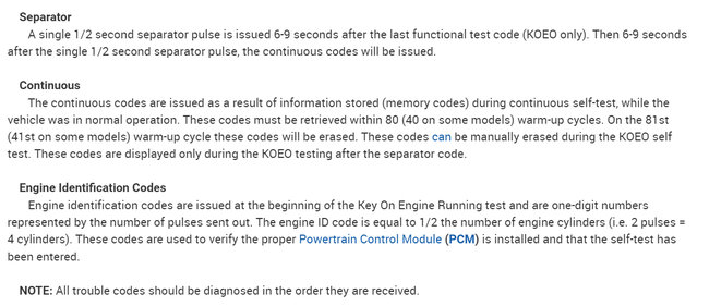

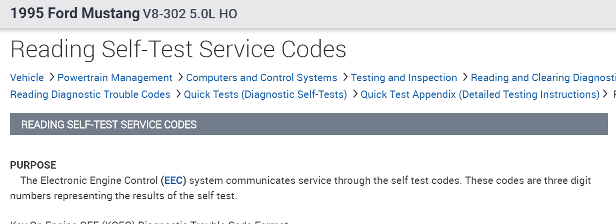

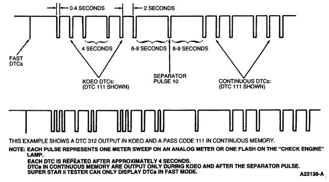

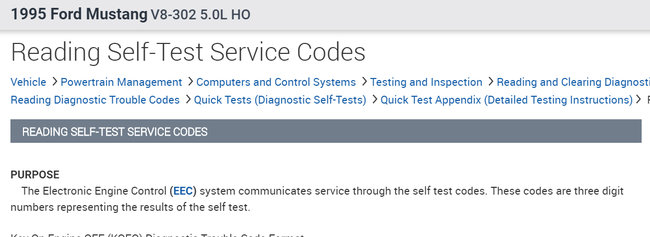

Can you get me the code from the Malfunction Indicator Lamp (MIL)/Check Engine light? I have included instructions on how to retrieve them in the diagrams down below. Please get back to us with what you find out.
Thanks,
Alex

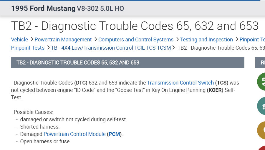

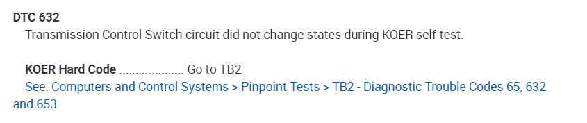

I bought an obd1 code reader and I got codes:
632
536
213
Help please!

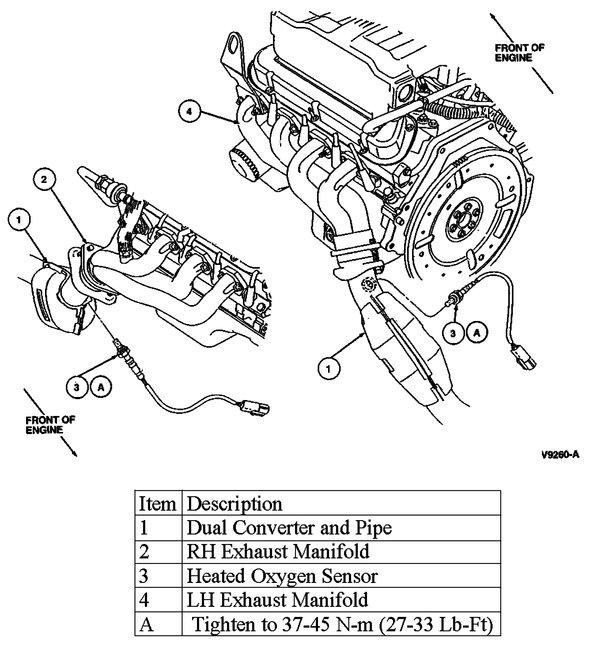

HARRY P
  • 2,296 POSTS
Personally, I would suspect 1 of 3 possibilities. (1) A clogged catalytic converter. This would not allow the engine to breathe out, causing too much back pressure on the engine, and seriously restricting it. (2) A lack of air flow. Less likely, but if the air filter is unbelievably dirty, the engine won't be able to get enough air in to create the power that you're looking for. (3) A lack of fuel pressure. A clogged fuel filter, or a failing fuel pump, could cause this. Much like the issue with the air filter, the engine wouldn't get enough fuel to do what you're asking it to do, resulting in performance issues.
All that said, is the service/check engine light on? If so, let's get it scanned. Even though this is a 1995, it does have OBD2 (required as of model year 1996). Take it to the parts shop and if they ask what year it is, tell them it's a 1996. Otherwise they may try to cop out of checking it. Report back here with the code numbers (not just their translations, but the actual numbers). We can use that to point us in the right direction.
If you can shoot and upload a decent video of it happening, that might be helpful as well.
If the light is not on, then I'd start with checking catalytic converter performance. The simplest way to do that is to remove the oxygen sensors that are on the exhaust pipe, between the engine and the catalytic converter. This allows the engine to breathe some because the back pressure won't build. But, it'll be loud. Like really loud. Like "wake the neighbors" loud, so do it when no one around would be asleep. I'm attaching images to aid you in pulling the sensors. If memory serves, you'll need a size 7/8 inch wrench to get them off.
The other possibility that I haven't mentioned above is potential serious transmission issues. Hopefully that's not it.

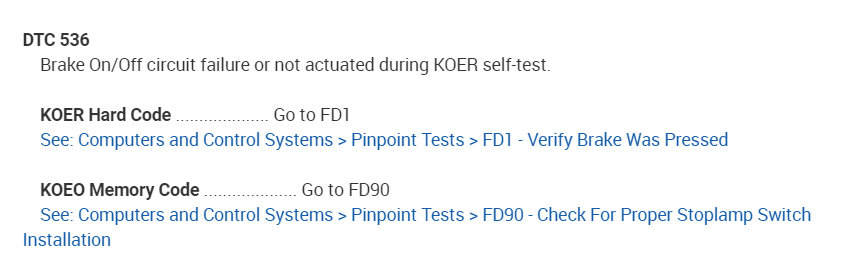

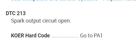

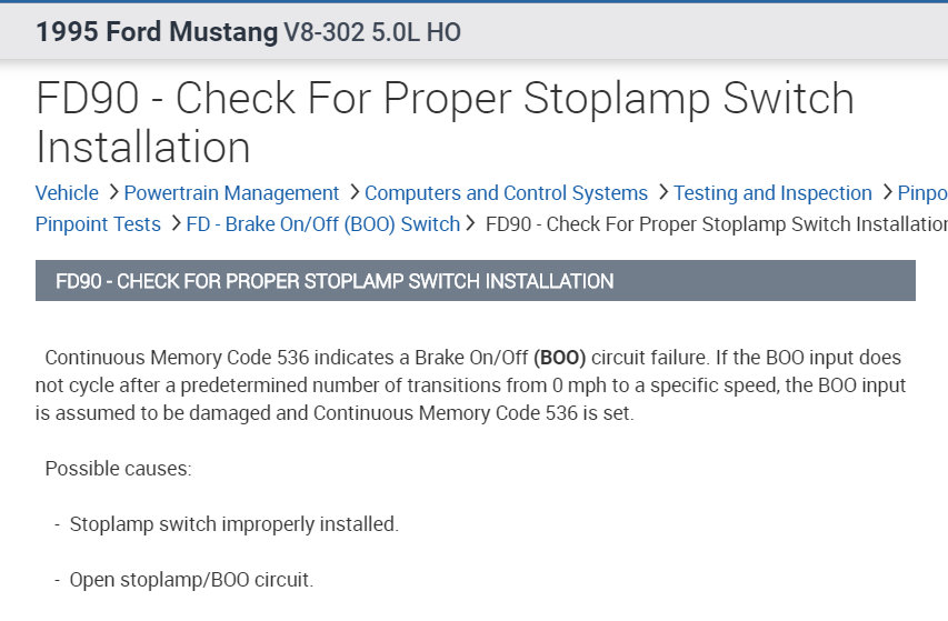

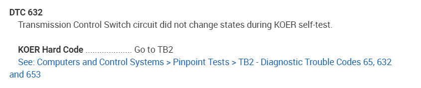

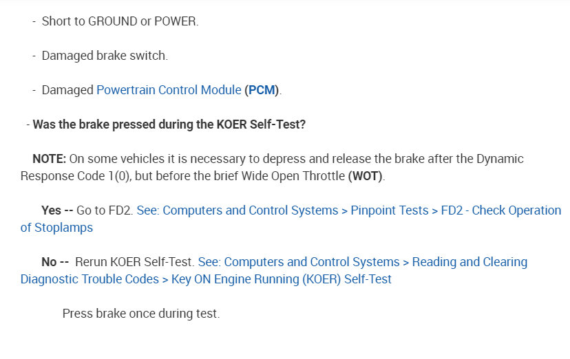

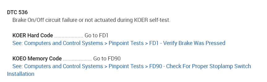

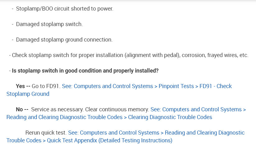

I have an obd 1 reader. I got the following three codes:
1. 213
2. 536
3. 632
Thursday, April 25th, 2019 AT 3:32 PM

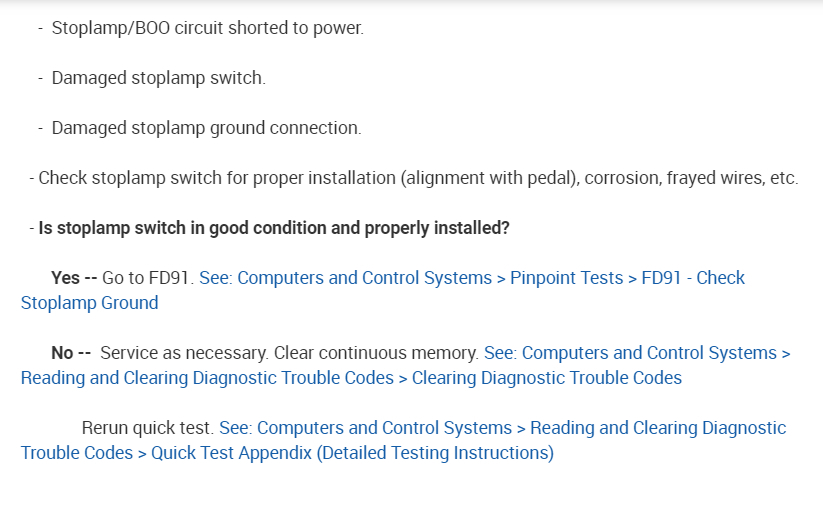

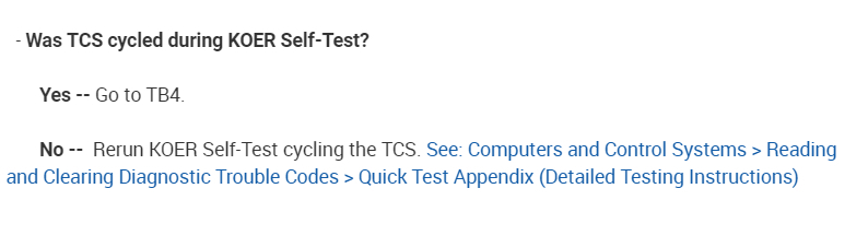

SCGRANTURISMO
  • 4,897 POSTS
Hello again,

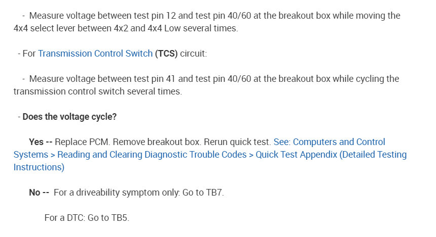

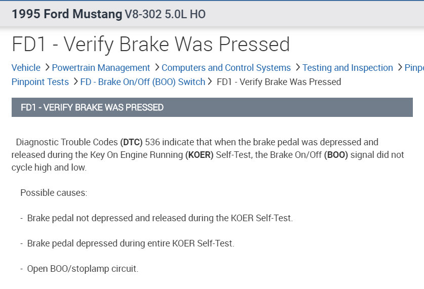

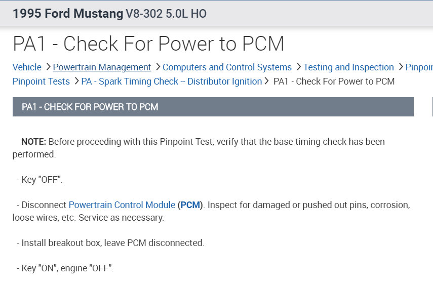

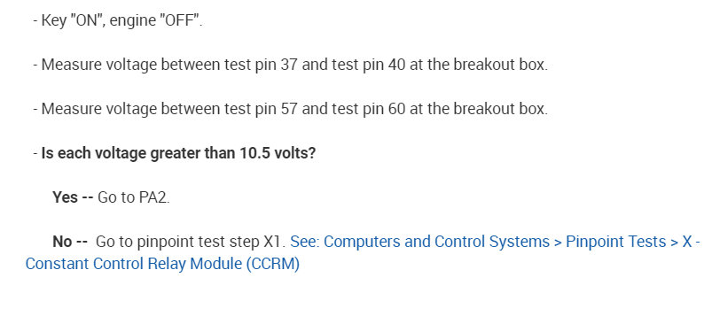

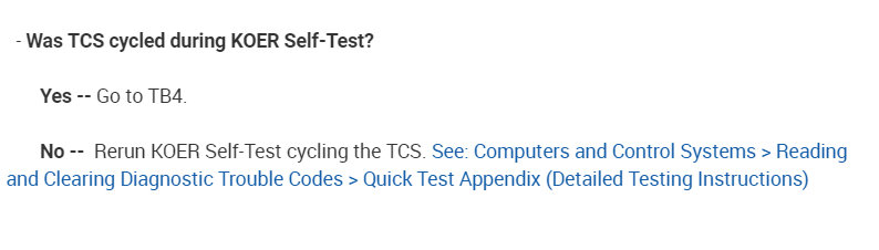

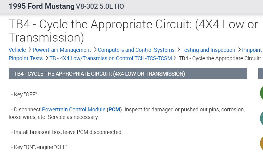

I have included the information for your vehicle's three DTC's in the diagrams down below. Please go through the guides and get back to us with what you are able to find out, please.
Thanks,
Alex
