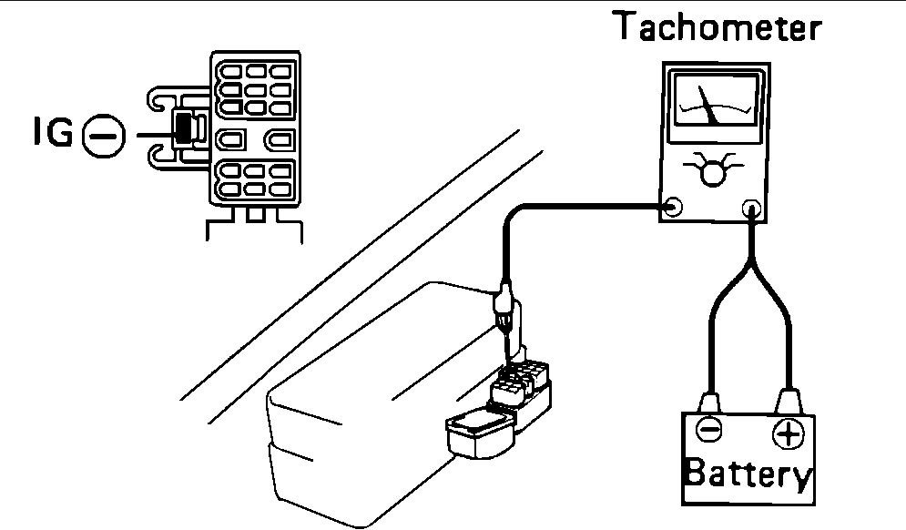

Tachometer Hookup
imageZoom/Print

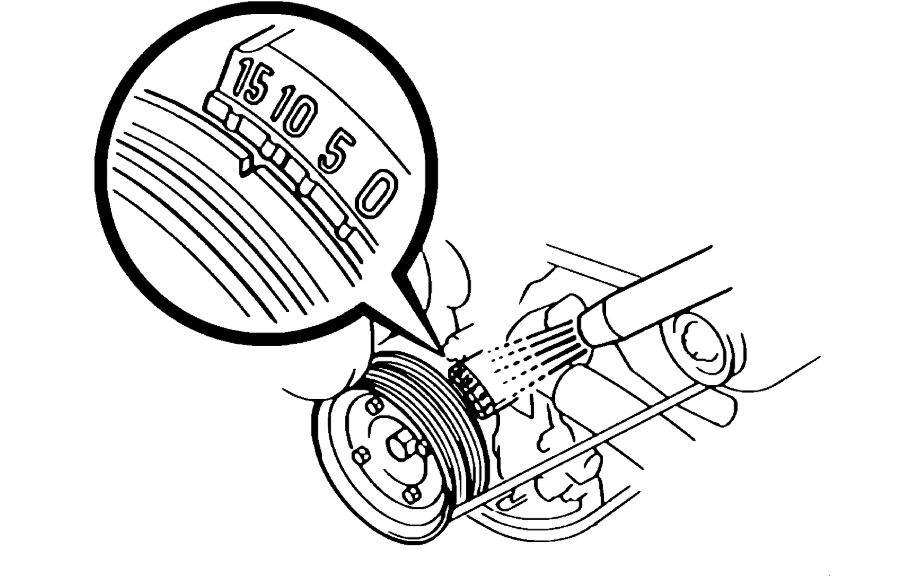

2. Attach a timing light with advance indicator and a tachometer.
Fig. 223 Ignition Timing (10)
imageZoom/Print
3. While operating the engine at 2,000 rpm, check the ignition spark advance and calibrate the timing mark to 0° TDC.
4. Using a wrench or small hammer, tap the exhaust manifold and observe the timing marks.
5. The ignition timing mark should move in the retard direction, depending on the intensity and speed of the tapping.

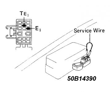

  • 75,992 POSTS

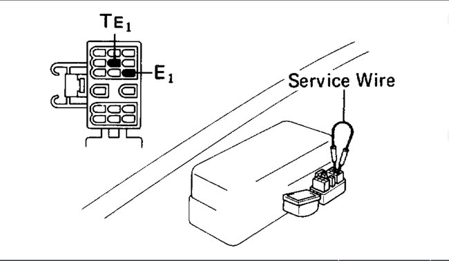

Try removing the EFI fuse to clear the CEL if not pull the code/s by jumping Te-1 to E-1 in the diagnostic connector-this is your starting point of diagnosis this guide will help
https://www.2carpros.com/articles/toyota-trouble-code-definitions-and-code-gathering-method-1990-1995

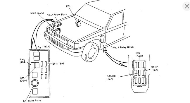

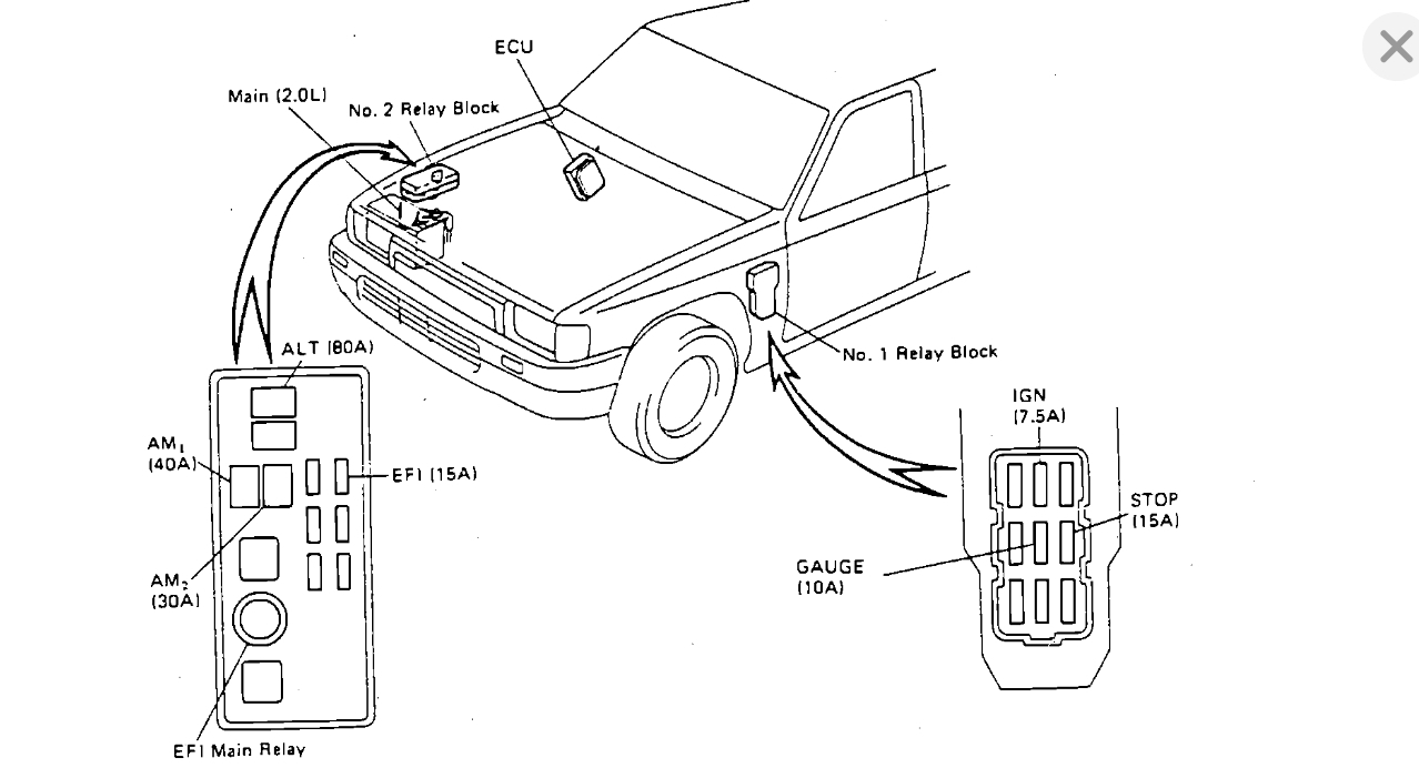

BOXSTER617
my truck kept popping EFI fuses so I check o2 sensor. When new engine was put in the mechanic never supported the wire going to the o2 sensor. Needless to say the exhaust melted the wire coating on all four wires to the o2. I have repaired the wires and so far no fuses have popped but the check engine light is still on. I unhooked the battery for 10 minutes and check engine light still on. The only thing I can thing that might be wrong in the carbon scoring in the wires from being in the exhaust. Maybe I didn't cut back far enough on the wire before reconnecting. Could this be it? A poor connection of the o2 wires?

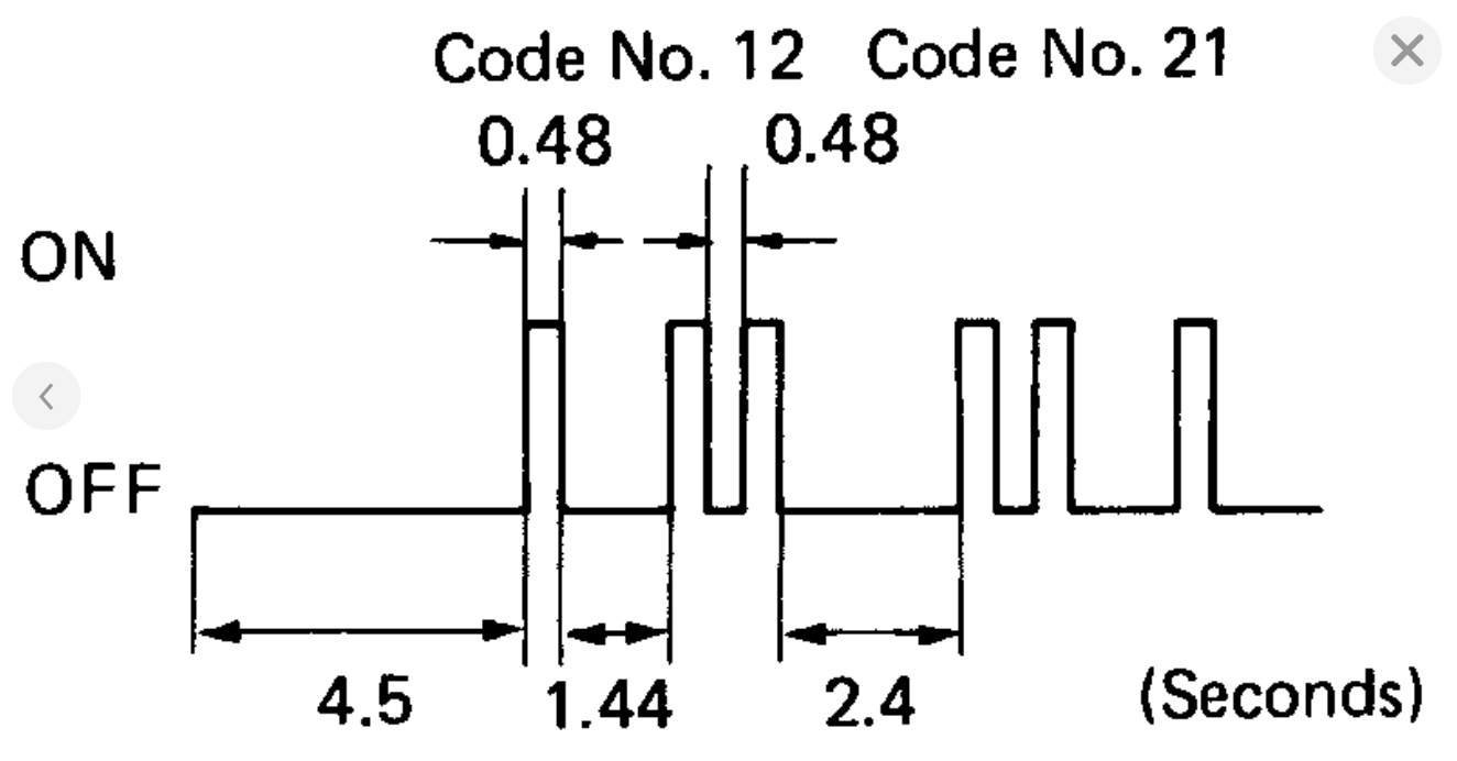

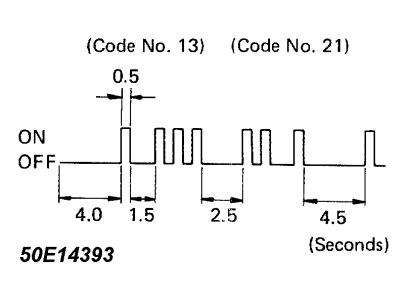

DOCFIXIT
  • CERTIFIED EXPERT
  • 18,828 POSTS

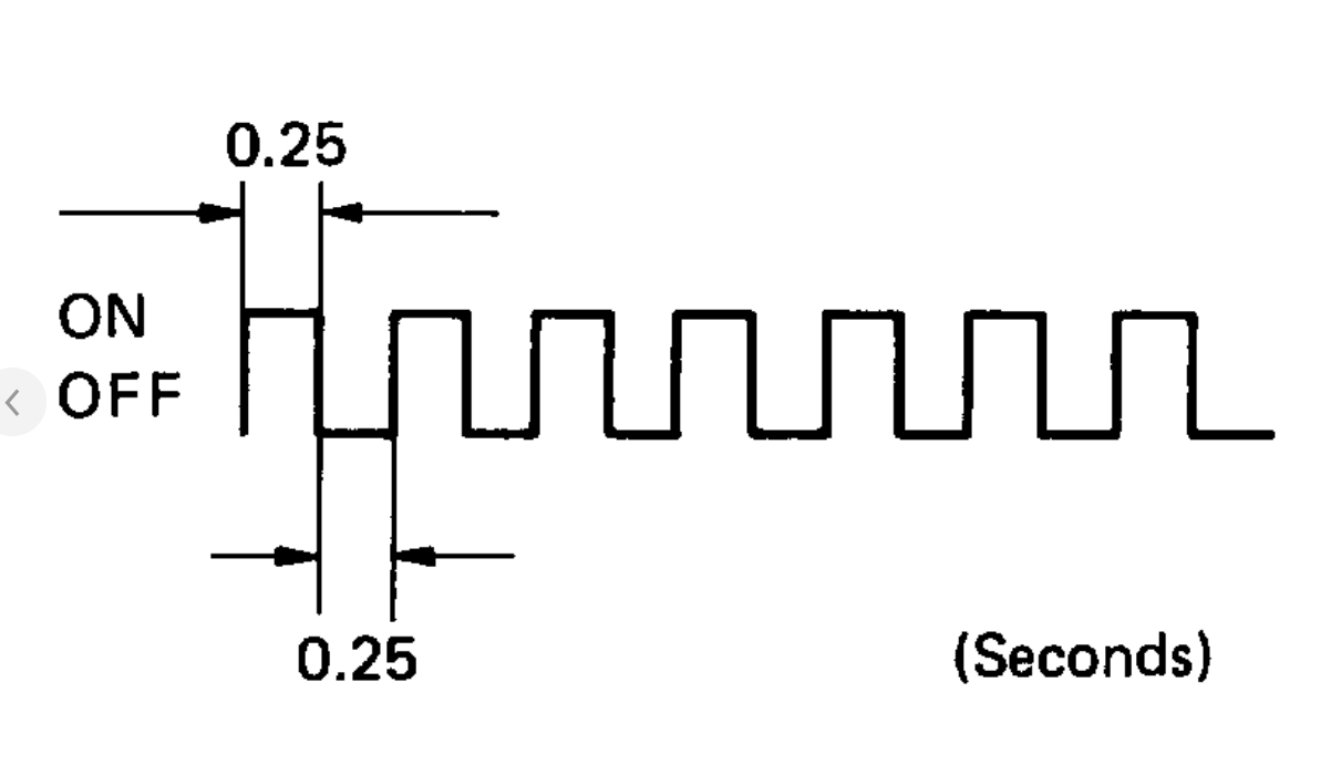

HI Find test connector near fuse box key on jumper wier from TE1 to E1. Check engine light will flash see diagram on how to read
https://images.2carpros.com/forum/automotive_pictures/198357_Graphic_522.jpg
https://images.2carpros.com/forum/automotive_pictures/198357_Grafic_3_133.jpg
Then post codes will advise. Wires to O2 neeed to soildered any increased resistence can cause trouble. Thanks for donate

BOXSTER617
**_*___*****_* I think it is 21 then 51.
Does this sound right?

BOXSTER617
I think letting the vehicle sit for awhile is what it needed. I started it up about 2hrs later and no check engine light. I will keep monitoring the CEL but it looks like problem solved. Thank you for your knowledge. I have learned more problem solving skills.
